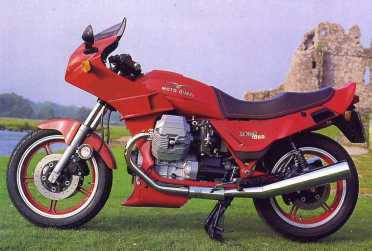

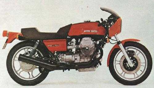

moscowphil Posted January 25, 2009 Share Posted January 25, 2009 That's the spirit, Kuan Well done, mate. She sure is stunning (both your wife and your Guzzi ) and the round headlight looks so much better than the square one. Hats off! Søren Yes the round headlight does look much better. What's interesting is that the prototype of the 1100 sport did have a round headlight, and also looked superb. But by the time it got into production it had the strange lozenge shaped one. I reckon Guzzi must employ somebody whose sole job is to ruin the looks of the bikes created by their engineers by slapping on a bit of pseudo-japanese styling. They have always done it - we could have an interesting competition to come up with the worst Guzzi styling exercise ever. To start you all off how did they manage to turn this into this? Link to comment Share on other sites More sharing options...
