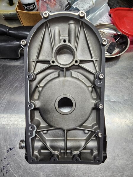

guzziart 344 Posted November 15, 2022 A few weeks ago my Lemans got stuck in 2nd gear….oem shift spring failure. I replaced the spring with the Chuck & Scud Super Duper Indestructible Spring. While I was in there, I also replaced the detent roller with a 688-2Z bearing (per Docc’s recommendation, I think) purchased from McMaster-Carr, they’re local to me. Polished the selector shaft, checked preselector plate, boss and cam clearance. Now I’m just waiting on a new shift shaft seal. Big thanks to those guys and the rest of you guys that contributed to the Shift Improvement thread and Re-Engineering the Shift Spring threads. Thank you! 2 1
