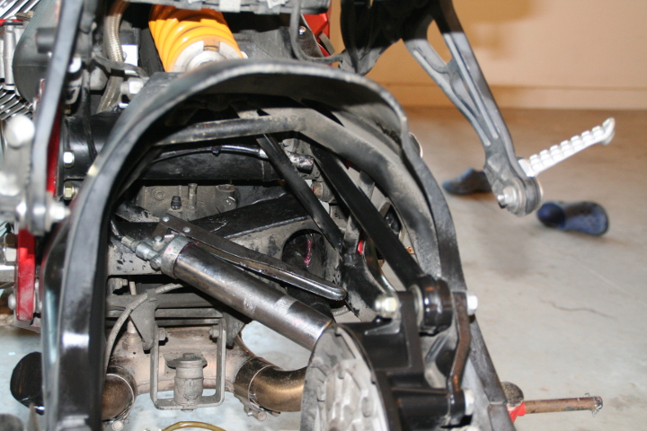

JBBenson Posted June 23, 2014 Posted June 23, 2014 This worked for me without removing the rear wheel or anything else. I got an adjustable swivel coupler grease tip, removed the tube, spring, and the sliding collar, and ground down the tip (more than expected) until it snapped on. You will need to use both hands. Get the zerk facing up, grease fitting bent slightly about 30 degrees, and push slowly in until it snaps on. It seemed like it wouldn't work but it did. Took a few tries to get it, but now it goes on easily. This tip: http://store.kvalinc.com/grease-gun-extension-adapter-threaded-8-long-rigid-extension-tube-with-swivel-coupler-p8282.aspx After modifying: 1

GraeV11 Posted June 23, 2014 Posted June 23, 2014 This worked for me without removing the rear wheel or anything else. I got an adjustable swivel coupler grease tip, removed the tube, spring, and the sliding collar, and ground down the tip (more than expected) until it snapped on. You will need to use both hands. Get the zerk facing up, grease fitting bent slightly about 30 degrees, and push slowly in until it snaps on. It seemed like it wouldn't work but it did. Took a few tries to get it, but now it goes on easily. This tip: http://store.kvalinc.com/grease-gun-extension-adapter-threaded-8-long-rigid-extension-tube-with-swivel-coupler-p8282.aspx After modifying: Did something similar, getting it off again was also a 'challenge' with much swearing and despair.
luhbo Posted June 23, 2014 Posted June 23, 2014 ... Did something similar, getting it off again was also a 'challenge' with much swearing and despair. Be carefull! Zerks are brittle. They snap really easy! Hubert
JBBenson Posted June 23, 2014 Posted June 23, 2014 ... Did something similar, getting it off again was also a 'challenge' with much swearing and despair. Be carefull! Zerks are brittle. They snap really easy! Hubert Yes, I was afraid of this as well. I forgot to mention that I didn't adjust the grease fitting all the way tight/closed, but sort of halfway unscrewed. This meant that I needed to hold it onto the zerk with one hand while squeezing the gun with the other, but was able to pull it off without a lot of drama or breakage.
