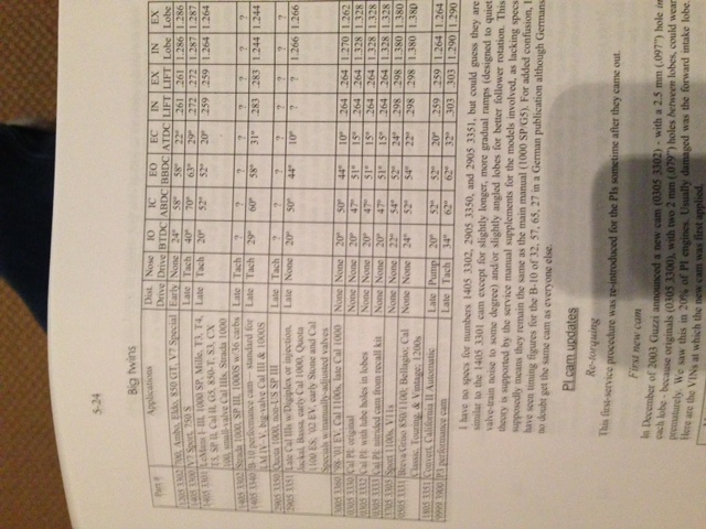

czakky Posted October 12, 2016 Posted October 12, 2016 Here's this from guzziology somebody smarter than me can translate.
docc Posted October 12, 2016 Posted October 12, 2016 Thanks, czakky! Looks like all of the Sport 1100/ 1100 Sport-i and V11 cams have the same part number, according to Dave Richardson (a solid and reliable source He states the 1064 sport cam lift is 0.298". As Richardson says, cam specs are influenced by valve lash. Is this why the Megacycle lift specs and the Mike Rich specs differ so much? Nonetheless, a 620-11 (and several aftermarket cams) look like they will require some careful head work.
docc Posted October 13, 2016 Posted October 13, 2016 I see that czakky's reference to Dave Richardson's Guzziology has several sections devoted to cams including a reference section on the Megacycle cams. While the duration numbers are the same as the Mike Rich numbers, the lifts are not (over 0.400"). All the lifts in Guzziology agree with the Megacycle Cam .pdf. All are over 0.300", but not over 0.400" as Rich lists. *Difference in valve lash?* As to ScuRoo's original post, "Why not a 620-11 for a V11?" 1064cc/Sport cam: 0.298" lift / ~256º duration (exhaust is likely shorter) 620-11 Megacycle: 0.360" lift / 282º duration With my very limited knowledge of high lift/ high duration cams, isn't it all about the heavy breathing at the highest rev range? In that case, It seems the "Crane" derived 1064/Sport cam is pretty well optimized for the usual tasks of a sporting street bike. That said, I'd just love to listen to a V11 with a 620-11 at it's angry idle. Then on the howl!

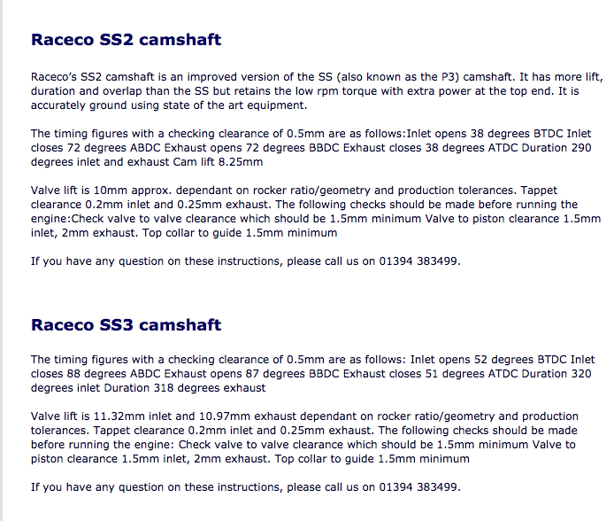

ScuRoo Posted October 16, 2016 Author Posted October 16, 2016 On the Megacycle listing for the 620x11 it is clearly described as the "Norris SS. Drag Race/Hi Performance" http://www.dpguzzi.com/megacams.pdf Now, Raceco also describes their improved SS2 thus: "Raceco’s SS2 camshaft is a development of the Italian SS (also known as P3) camshaft. The SS2 Cam has more duration and overlap than the old SS but still retains the low down pulling power with the added bonus of extra power at the top end. This is our most popular road cam. It has been fitted with excellent results to everything from Converts to LM5’s. This cam requires checking for valve to valve and valve piston clearances, components may have to be machined for correct fitting. We will fit it for you if you wish." http://www.raceco.com/motog.html So, the identity question remains, is the "Italian SS (also known as the P3) Raceco are referring to - actually the Norris SS, or has this "SS" designation been coincidently used twice, the Italian SS (or P3) and the US company Norris independently developed their own "SS" version…? Then again, Raceco describe their Raceco SS3 camshaft as: "Designed specifically for V11 and Sport 1100 type engines. As the original camshaft in these engines is very similar to the SS2, we have decided to make a more powerful alternative available." The Internet - all over the shop like a mad woman's breakfast. Grrrrr. So, in short, what's correct order of cams going from hot, hotter, hottest? Is the order 620x10, followed by the Raceco SS2, then 620x11…? Or is it - Raceco SS2, 620x10, then 620x11? Anyhow, one thing is clear - Kent Cams confirms they can reprofile a supplied V11 cam into the Raceco SS2 for GBP128 - & the GBP has Brexit plummeted!

docc Posted October 19, 2016 Posted October 19, 2016 1064cc/Sport cam: 0.298" lift / ~256º duration (exhaust is likely shorter) 620-11 Megacycle: 0.360" lift / 282º duration So, in short, what's correct order of cams going from hot, hotter, hottest? Is the order 620x10, followed by the Raceco SS2, then 620x11…? Or is it - Raceco SS2, 620x10, then 620x11? Using Guzziology's table of Megacycle/ Norris specs, it appears the progression to the hottest is: (620-) 3 -> 9 -> 10 -> 11 -> 8 -> 7 The P3 looks to have significantly longer duration (20º more intake, 18º more exhaust [276ºI/274ºE] and only 0.004" more lift [0.303"] than the 1064 Sport cam. So, we might say the P3 is a bit "hotter" than a 1064 Sport cam. All of the Megacycle cams have higher lift than the 1064 Sport or P3 cams. Duration numbers place the two Guzzi cams before and after the 620-10, realizing the 620-10 has higher lift than the P3 [0.335"). But where the SS2 and SS3 compare depends on the actual specs. EDIT[19 Oct 2016]: I found this technical section on the Raceco website. Looks like it would be good to archive this while the Raceco site is still supported. http://www.raceco.com/technical.html#ss2
