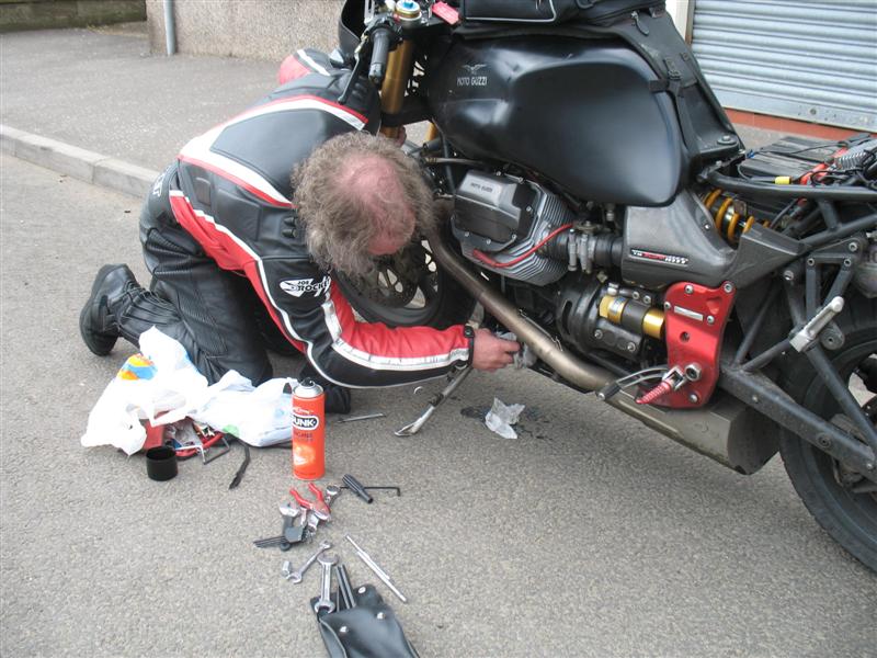

Admin Jaap Posted May 31, 2007 Share Posted May 31, 2007 BFG doing some roadside repairs: Link to comment Share on other sites More sharing options...
