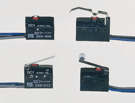

Guest Nogbad Posted March 13, 2005 Share Posted March 13, 2005 Note the rubber boot and external lever pivot on the OE "Cherry" switch. This Cherry switch is IP67 sealed against water ingress. The Radio Shack switch may have the same dimensions but is not a waterproof switch. If you only ride in the summer, ok. If you ride in the winter or in the rain I don't give that new switch much of a chance. In the UK these Cherry switches can be bought from RS Components part number 290-0491 for £2-63. They are also available with potted flying leads at £3-51, part no 320-506 Switches here RS Components will accept international orders. Link to comment Share on other sites More sharing options...

Guest Nogbad Posted March 13, 2005 Share Posted March 13, 2005 When I have to change mine I shall go for the version with potted in flying leads and will resite the connectors somewhere dry. Same goes for the clutch switch if that plays up. I won't bother shortening the loom, just loop up the excess cable and zip tie it. I don't think the spade connectors are well served by being outside in the elements. I already had to clean mine twice to get the stop lamp back. Nothing wrong with the switch just corrosion on the connectors. Link to comment Share on other sites More sharing options...
