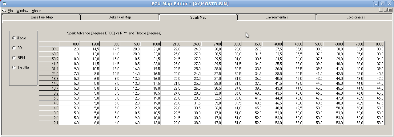

raz Posted January 7, 2010 Share Posted January 7, 2010 Just to revive this thread: does anyone know by how much a TPS changes the ignition curve and where in the rpm range?I am running a P8 computer with carbs and was advised to set the TPS at full throttle to make it work. I would like to find out what would change if I would set it at for example 1/2 throttle; would the idle advance change or just the advance from a certain rpm and up? Do you mean the TPS is not connected to the throttle cable so you need to find a static compromise? It shouldn't be that hard to connect it (maybe temporary) to the throttle cable. I doubt WOT will be a good place to set it. There are some logs in this post where you can see some Cali P8 ignition advance stuff, like that it seems to be about 10.5 degrees at idle. Maybe it could be of some value for you. Edit: On a second thought, WOT is not that bad. Of course it will still consider the RPM. This is my (1100 Sport) stock ignition map: If I put carbs on and just set the TPS to WOT (that can be done by getting rid of the actual sensor and just shortening two of the cables, isolating the third), I would get 12 degrees at idle and 30 degrees at WOT. That should work, even if it's not very optimal. As you can see, if your map has any similarity to mine, you'd end up with too much advance if you set it on half throttle. YMMV. Link to comment Share on other sites More sharing options...

JR1967 Posted January 8, 2010 Share Posted January 8, 2010 Thanks for the replies guys! Sharperdill: I am already running on 36mm Dellorto's and use stock jets for a Cali 1000 as a base setting. Since the idle jets seem too lean for proper running I thought that my idle advance must be wrong with the TPS set at full throttle. And Raz's posted advance map confirms this. Raz: Thanks for your elaborate answer; it looks like I should shoot for a TPS figure in the 53.9-68.2 degrees TPS range to get a proper full advance number like 33-34 degrees. Problem is that anywhere below that nothing seems to even remotely resemble a carbureted Cali advance curve. I am pretty confused..... My hope was to find out what % TPS setting would work and then replace the TPS with a resistor of the correct value. I did a lot of reading in the post that you mentioned but I am not much wiser concerning my problem. Any thoughts? Thanks, JR Link to comment Share on other sites More sharing options...
