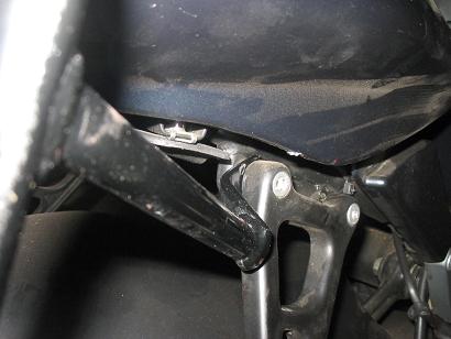

rocker59 Posted February 22, 2007 Share Posted February 22, 2007 Hey Lee, There simply is not enough room to leave the winkers in the OEM location. You'll have to mount them on the H+B brackets. Not the tidiest solution, but it works. The brackets kind of ugly up the looks of the V11, but it sure is nice having the luggage! Mounting the brackets is not that tough, but it does require some disassembly of the motorcycle and some time and patience on you part. I'll go out and take some pictures in a few minutes and add them to this thread. Link to comment Share on other sites More sharing options...
rocker59 Posted February 22, 2007 Share Posted February 22, 2007 To install the brackets, the plastic tail section has to be removed. Reinstalling it is tight. Take care not to scuff the paint. Notching the inner mudguard was the only pain. I used a coping saw and then a file to shape it. Getting the central bracket bolted to the seat subframe was kind of tedious. Be sure and use antiseize on the bolts. It might be a good idea, too, to test fit the bolts prior to final assembly. A couple of the tapped holes were rought on my brackets and required some care to keep from cross threading the bolts. If you have any specific questions, feel free to ask. Link to comment Share on other sites More sharing options...

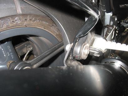

Guest Britcheflee Posted February 22, 2007 Share Posted February 22, 2007 Hi Mike, Thanks for the great pics which really help - I was looking at the cross connector with the tab and wondering where on earth that was going to connect to - now I understand as that part needs to be notched out. I am going to pm you with my e mail address as I probably will have a couple more questions but have asked the first here in case anyone else needs to mount these: On the side mounts there are two tabs which connect to the two bolts on the triangular part of the frame of the bike (there are two allen bolts at the top and one at the bottom) - the bottom one is where the rear foot peg attaches to - I have posted two pics - on the upper one when you add the mount do you need to shim the other bolt where it connects? Or can you just crank down on the other allen bolt and it will take up the gap? Do I have the bottom connector in the right place or does it go on the other side? When you notch out the underneath of the wheel area is there two obvious spots to connect the mount to or do you have to fabricate one? I am going to get some loctite to make sure all bolts stay in place. I was also going to see if there was a way of getting tricky and getting some led lights for the turn signals and/or the brake lights that I can attach directly to the bags with a quick connect/disconnect tab...if not Ill go to the method you have employed. Link to comment Share on other sites More sharing options...
rocker59 Posted February 23, 2007 Share Posted February 23, 2007 There should be a longer bolt and nut to mount the upper front mount on the inside. The muffler mount also goes on the inside. Remember, you'll need to have the tail plastic off the bike to fully access the footpeg bracket bolts. Link to comment Share on other sites More sharing options...

Guest Britcheflee Posted February 23, 2007 Share Posted February 23, 2007 There should be a longer bolt and nut to mount the upper front mount on the inside. The muffler mount also goes on the inside. Remember, you'll need to have the tail plastic off the bike to fully access the footpeg bracket bolts. Yikes! Thanks for that info - a picture paints a.....I am off to Home depot tomorrow to get some longer allen bolts as the upper bolts are not long enough - I have a new dremmel tool so I am going to try to just cut a slot big enough to get that tab in through to connect to the two bolts under the seat. I will take your advice and put it together loosely then gradually tighten everything up and give it a shot of loctite as well. I notice you have the Moto guzzi emblem on your bags - mine has the HB logo - can you buy a MG stick on logo to replace this. I agree that the mounting frame does distract from the basic beauty of the bike - but I can live with that and look forward to being able to use the bags on longer trips. Lee Link to comment Share on other sites More sharing options...
rocker59 Posted February 23, 2007 Share Posted February 23, 2007 I started out with a slot, but made it into a notch to be able to access the nuts to bolt the bracket up tight. Yes, the Guzzi logos are available. Eurotech Motorsports is the H+B importer and has them. I've seen them other places, too. As you mentioned, it is a good idea to test fit everything loosely before tightening everything down. Good luck! Link to comment Share on other sites More sharing options...

Zoom Zoom Posted February 24, 2007 Share Posted February 24, 2007 Lee, it looks like Mike has covered it pretty well. I would add a couple of things. Under the tail piece, where the cross bar mounts up, I needed to remove that piece and knock off the nuts that were spot welded in place. Otherwise, the bar was too low to line up with the side brackets. There are three nuts under there. I only needed to do that to the front two. They came off without much trouble. Also, in order to get the side bracket to line up properly, I needed to elongate the lower front mounting hole on the right side. Without doing that, I was unable to get things to line up properly. Mine may have been bent, but if it was, it was before the paint was applied. After you have everything loosely attached, minus the top rack, that is the time to put the tail piece back in. It is nearly impossible after you tighten things down. I can't remember if I needed to just set the tail piece in place or tighten it up before finishing the install. THE KEY IS THE CROSS PIECE THAT FITS UP UNDER THE FENDER. THE TOP OF THAT SHOULD FIT FLUSH WITH ITS MOUNTING, NOT ON TOP OF THOSE BLIND NUTS. Everything else should line up to that piece. The hole I needed to elongate was done to the bracket itself and was completely hidden under the washer after the installation was finished. At the risk of tooting my own horn, I would say the I know my way around a wrench. This job took much longer that I originally figured. Just take your time, make sure things line up properly. The end result will be worth the effort. Zoom Zoom, John Henry Link to comment Share on other sites More sharing options...
leroysch Posted March 28, 2016 Share Posted March 28, 2016 FWIW, I didn't have to knock off those captive fasteners which are part of the bike's rear bracket supporting the mudguard, license plate frame, etc. It was helpful to take the HB bolts and take advantage of the captive fasteners to make a cross brace/rear bracket "assembly" and then use the HB nuts to fasten it to the bike's frame. With everything loosely attached (rotated Ti exhaust, stock passenger brackets, both side brackets for the HB bags, turn signal relocation bar) everything lines up! Link to comment Share on other sites More sharing options...
