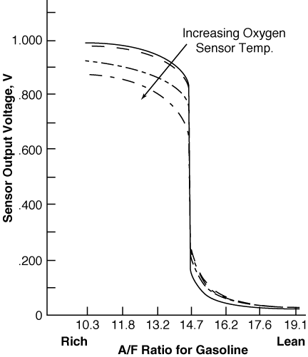

JuhaV Posted November 25, 2004 Posted November 25, 2004 What I will try next is a true wideband sensor. I hope this will give more accuarate results. Also it will enable me to find a fuel map with 0.8 as lambda target. With the help of excel and a lambda=1 map I will then be able to figure out a map that has 0.8 for full load and 1 or even 1.2 for other cells, thus improving further power output and economy. 37888[/snapback] Hi, Here are a couple of response curves for normal, cheap narrowband lambda sensors. According to my experience (My16M in a Sport 1100i), it is quite possible to use even these cheap sensors for closed-loop and target for lambda 0.80-0.85 values (slightly rich, maximum power). I use lambda target voltage around 0.8 Volts in my bike. I would think, that you would not like to drive with lambda values > 1 in any circumstances even to improve the economy, because these engines do not run properly with that lean mixture. You will get hesitation, misses and all sort of "not nice" behaviour. Keep it rich enough and you will get a very nice and smooth power delivery. BTW, my bike uses around 5.5 liters/100 km. Some stuff about building a My16M ECU per Cliffs instruction can be found from : http://www.kolumbus.fi/koivupiha/ecu.htm br, JuhaV
