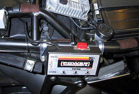

al_roethlisberger Posted June 9, 2003 Share Posted June 9, 2003 I was looking around for a good place to more or less permanently mount the PCIII on the LeMans. But since I have a pretty full tool-kit in the tool-kit area, and I do use the tail "cubby" for ad-hoc items on trips, etc... I didn't want to have to just lay the PCIII in either of these locations. So after looking around, I found that the PCIII will fit quite well mounted to outside of the seat subframe on either the left or right side, between the frame and rear plastic carapace. I simply used some 3/4" metal conduit hangers, with rubber protectors. You can find these at any hardware store. In combination with some stainless M6 bolts and lock-nuts, it was an easy and tidy solution. Here are some photos: Link to comment Share on other sites More sharing options...
al_roethlisberger Posted June 9, 2003 Author Share Posted June 9, 2003 A better look at the installation itself: Link to comment Share on other sites More sharing options...

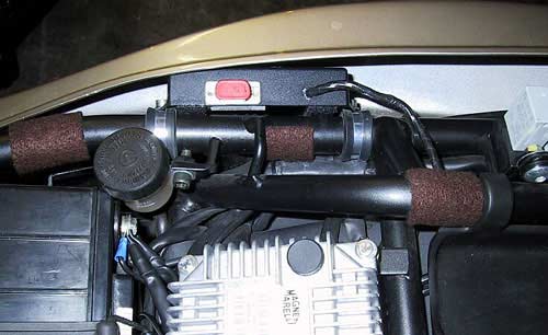

al_roethlisberger Posted June 9, 2003 Author Share Posted June 9, 2003 From a slightly different angle: Link to comment Share on other sites More sharing options...
dlaing Posted June 9, 2003 Share Posted June 9, 2003 Nice job. Can you remove it without removing the cowling. Link to comment Share on other sites More sharing options...
al_roethlisberger Posted June 9, 2003 Author Share Posted June 9, 2003 No, that would be one drawback if one wanted to get to the manual adjustment buttons, or somehow wanted to remove it "easily". You cannot remove the PCIII with the tail-section installed. However, I figure once I get the custom map set, I won't be fiddling with the manual buttons or need to remove/move the PCIII around. So my only concern was making sure one had easy access to the serial port. Also, I can get my rear carapace off in about 2 minutes now, so it's not a big deal for me in any case al Link to comment Share on other sites More sharing options...
RichMaund Posted June 9, 2003 Share Posted June 9, 2003 Bravo Al! Very cleanly done! I tried to think of a way to put mine there but came up blank. Those bits of hardware are inspired for the job. Conduit hangers? As a mechanic, I never used them. I have to add that to my Library! Thanks Al! Link to comment Share on other sites More sharing options...
al_roethlisberger Posted June 9, 2003 Author Share Posted June 9, 2003 Yeah, I think that's what the package said, "conduit hangars" But bottom line, they are just cheapo pipe brackets from sheet metal, with a rubber lining. I found them in the electrical section, but they could be in plumbing too I would bet. al Link to comment Share on other sites More sharing options...
Guest Brent Posted June 9, 2003 Share Posted June 9, 2003 Great idea! I never did like the sloppy look of the unit sitting in the rear tail section. By the way, what are those strips of material for on your frame? They look as if they're placed where the seat touches the frame. Link to comment Share on other sites More sharing options...
al_roethlisberger Posted June 9, 2003 Author Share Posted June 9, 2003 Yep, that's felt The bumpers from the seat were rubbing the coating off of the frame, and I didn't want to end up with rust/bare-metal spots after a couple years like I had on my FJ. So I stuck some "heavy duty" felt on there. It works OK, although I have to press it back down sometimes, and after a while it wants to "creep" from the seat moving around a little. But it seems to be doing it's job. al Link to comment Share on other sites More sharing options...

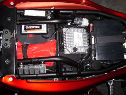

Guest Brent Posted June 10, 2003 Share Posted June 10, 2003 Well, although I would've liked to move my PCIII to the side (like Al's), it would mean having to remove at least some of the tail trunk frame before I could remove the tail piece, as well as re-routing some wiring. I wasn't THAT motivated to move the PCIII, but I did spend some time trying to locate a better place than the cubby, and I came up with this. I removed the tool tray, which gave me room not only for the PCIII but also for a larger tool kit. I'll keep the tool kit from shifting around by placing a folded rag over it to allow the seat to compress it. Here's a pic. Link to comment Share on other sites More sharing options...
