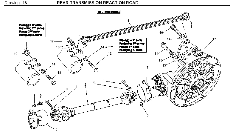

Guest SoCal Nick Posted February 15, 2004 Posted February 15, 2004 Does anyone have access to a micro fiche with part #'s? I'll try to explain what I need without butchering the explaination. I need to replace a rubber bushing that is in the end of the tie bar that holds the housing on the rear drive on the rear wheel. Make sense? The tie bar that I refer to is the one that runs parrallel to the drive shaft. I want the part # so I don't just get blown off by a dealer. Thanks in advance
Admin Jaap Posted February 15, 2004 Posted February 15, 2004 Here are two pics from the manual. from what I understand from your story the part should be on one of these/ Let me know the drawing and the number pointing to ithe part and I'll let you know the part number. Drawing 18
Paul Minnaert Posted February 15, 2004 Posted February 15, 2004 I think there's no part nr for that, as it comes in the bar vulcanized. So you have to make your own solution, or buy a new bar.

mznyc Posted September 4, 2009 Posted September 4, 2009 Is the part we're speaking of in one of the diagrams? Which #?,if it is.Would just like to be enlightened if I had this problem down the road.
twhitaker Posted September 4, 2009 Posted September 4, 2009 They're talking about the eyes inside either end of item # 1. If mine came apart on the road I would probably continue to ride it. If it got intolerable I would wrap the inner sleeve with enough electrical tape to make it fit the hole. Voila!
