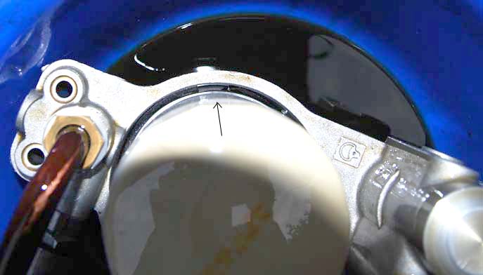

vuzzi Posted November 3, 2011 Author Posted November 3, 2011 I yesterday removed the oil sump (again) and took off the the oil filter holder. I was hoping to find a broken gasket but all was fine. Dissembled the OPRV hoping to find something that kept the valve open, but all was clean. I had no means to test it so but it back together. Next I replaced the 4 o-rings to the oil cooler. they seemed a bit flat, and the new ones seemed to be more tight. I was hooping this would solve the problem. Since right now I couldn't find anything else, I was about to refit the filter holder. But first gave it a visual 'inspection'. By pure coincidence I noticed a rubber ring between the filter holder and the filter that appeared broken. Took the filter off and there it was: Half of the rubber ring of the old filter was still there, as you can see on the picture. I clearly hadn't checked or noticed it when replacing the old filter two weeks ago. Put it all together again, now also with recommended hose clamp on the filter. I only haven't tested the pressure jet, cause I still need to get the oil in the engine from a small bowl without making a mesh. But I'm quite sure the problem is found and fixed. If not, I'll let you know... Thanks
gstallons Posted November 3, 2011 Posted November 3, 2011 I yesterday removed the oil sump (again) and took off the the oil filter holder. I was hoping to find a broken gasket but all was fine. Dissembled the OPRV hoping to find something that kept the valve open, but all was clean. I had no means to test it so but it back together. Next I replaced the 4 o-rings to the oil cooler. they seemed a bit flat, and the new ones seemed to be more tight. I was hooping this would solve the problem. Since right now I couldn't find anything else, I was about to refit the filter holder. But first gave it a visual 'inspection'. By pure coincidence I noticed a rubber ring between the filter holder and the filter that appeared broken. Took the filter off and there it was: Half of the rubber ring of the old filter was still there, as you can see on the picture. I clearly hadn't checked or noticed it when replacing the old filter two weeks ago. Put it all together again, now also with recommended hose clamp on the filter. I only haven't tested the pressure jet, cause I still need to get the oil in the engine from a small bowl without making a mesh. But I'm quite sure the problem is found and fixed. If not, I'll let you know... Thanks You are lucky !
tmcafe Posted November 4, 2011 Posted November 4, 2011 I yesterday removed the oil sump (again) and took off the the oil filter holder. I was hoping to find a broken gasket but all was fine. Dissembled the OPRV hoping to find something that kept the valve open, but all was clean. I had no means to test it so but it back together. Next I replaced the 4 o-rings to the oil cooler. they seemed a bit flat, and the new ones seemed to be more tight. I was hooping this would solve the problem. Since right now I couldn't find anything else, I was about to refit the filter holder. But first gave it a visual 'inspection'. By pure coincidence I noticed a rubber ring between the filter holder and the filter that appeared broken. Took the filter off and there it was: Half of the rubber ring of the old filter was still there, as you can see on the picture. I clearly hadn't checked or noticed it when replacing the old filter two weeks ago. Put it all together again, now also with recommended hose clamp on the filter. I only haven't tested the pressure jet, cause I still need to get the oil in the engine from a small bowl without making a mesh. But I'm quite sure the problem is found and fixed. If not, I'll let you know... Thanks
