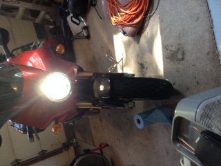

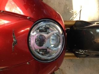

andy york Posted August 24, 2015 Posted August 24, 2015 I was riding back from Atlanta on the super slab at night a couple weeks back. I stood up and put my hand in front of the bike to see if the light was on. Thats how bad my headlight was. I told myself no more night riding till I have a proper headlite. I bought a J.W.Speaker 8??? and put it on the bike. No official night time ride of any distance, but preleminary results are outstanding. It takes a bit of work to make it fit, and requires more than a screwdriver. And NO I did not document the install very well. Probably have to take it apart to figure out what I did LOL... maybe my pics will load
Welshguzzi Posted August 24, 2015 Posted August 24, 2015 Which model did you fit? I'm guessing it was one of these? http://www.jwspeaker.com/products/led-headlights-model-8700-evolution-2/ And what sort of price are we talking? 1
andy york Posted August 24, 2015 Posted August 24, 2015 Yes - Thats the one. Kinda pricey - about 350.00 us - but I had to do something. I Know you can not put a hotter halogen in cause the system can't handle the load. This was my best alternative, plus it should be less draw on the charging system. there are many more options, but they involve a lot more work than what I did. In the end, I wanted a new type of lite. I feel the stock guzzi headlite is a piece of shit. Its just a big blob of lite that doesn't do anything. It has no Focus through a clear lens. If it was a projector lamp that would be different. It needs all those steps and facets on the inside to make the lite go where it needs to be. And the fact that its a plastic reflector doesn't help either. good luck !!
JBBenson Posted August 24, 2015 Author Posted August 24, 2015 Yes - Thats the one. Kinda pricey - about 350.00 us - but I had to do something. I Know you can not put a hotter halogen in cause the system can't handle the load. This was my best alternative, plus it should be less draw on the charging system. there are many more options, but they involve a lot more work than what I did. In the end, I wanted a new type of lite. I feel the stock guzzi headlite is a piece of shit. Its just a big blob of lite that doesn't do anything. It has no Focus through a clear lens. If it was a projector lamp that would be different. It needs all those steps and facets on the inside to make the lite go where it needs to be. And the fact that its a plastic reflector doesn't help either. good luck !! That looks good, I guess you made some kind of rim to close up the gap, as the original is 8". Cant be that hard. j.
andy york Posted August 24, 2015 Posted August 24, 2015 That company also sells a bucket for that Headlite. I Purchased one also. There bucket is about 5mm to wide on each side to fit the ears of a LeMans( rosso-tenni-etc...)It also has a vertical and horizontal adjustment assembly that I did use as well as the trim ring that came with the new bucket. The beauty to me is that I used the stock bucket and I can use the cool little stock vertical headlite adjustment. It would be quite the pain in the arse to have to take the fairing off to do the headlite. when I was done I had a new bucket (that I did not use) an old adjustment setup and the old trim ring left over. Had to drill a couple holes in the old bucket. But hey its all fun when your making it better.
