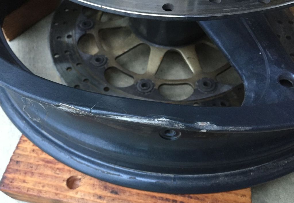

Scud Posted October 15, 2015 Author Posted October 15, 2015 How about a little advice on the front wheel? I think the wheel itself is beyond repair. Picture below shows the worst of the damage - the crack is through to the inside of the rim, which is flattened and flared out a bit. There's another gouge on the other side of the rim and some marks from impact all the way into the center channel. The bearings make a little noise. However, Rox wants the rotors (which are excellent and will clean up well) and I want to remove them without discoloring them. Not having removed rotors like these before, here's what I think I know: they are in with the strongest thread-locker known to man. Rox and I already tried leverage and mild heat (heat gun). I later tried an impact driver (the hammer kind). All I get is the allen-wrench stuck in the screw head - which means I am getting close to rounding out the screw head. I'm concerned that a gas torch will permanently discolor the rotors (and that's what a shop would probably do). If the wheel has no value (as I suspect) I suppose I could drill out the screws. I have an air-powered impact wrench, but no impact allen sockets (willing to buy a set). So.... what's a guy to do? How do you get these things off without discoloring the rotors (and for future reference - without destroying the screws)?

GuzziMoto Posted October 15, 2015 Posted October 15, 2015 I get those rotor bolts off by applying heat via a torch to the rim where they screw into. I do this from the side, typically from the other side of the rim. You don't need to, or even want to, apply the heat to the brake disk, but you can apply the heat to the bolt if you like. But I prefer applying the heat to the rim. 1
Scud Posted October 15, 2015 Author Posted October 15, 2015 ...let's have a quiz. Does anybody recognize this rear bracket? Perhaps for some type of saddle bags or top case? Moto Guzzi or aftermarket? The tubed bracket is part of the Ventura rack fitting kit, do I get a prize? You win a "like" and an a beer emoticon: You could also claim a guided V11 tour of San Diego back-country roads as your "prize." Must be present to win... I get those rotor bolts off by applying heat via a torch to the rim where they screw into. I do this from the side, typically from the other side of the rim. You don't need to, or even want to, apply the heat to the brake disk, but you can apply the heat to the bolt if you like. But I prefer applying the heat to the rim. Thanks. That makes sense and I will try it soon - hopefully this evening or at least over the weekend.
PDoz Posted October 15, 2015 Posted October 15, 2015 Re the disk bolts, do you have the ability to do a hot / cold cycle? Ie heat the rim, freeze the bolt, repeat a few times. I just bring the liquid nitrogen chryotherapy gum home from work....but there are apparently vehicle versions ( or your chemist might sell liquid co2 wart sprays?) . I also hit the end of the bolt using a hammer / punch - the old mechanic I worked for believed it broke the rust. I mostly do it because it feels good. As an added bonus, you have a centrepoint to drill into if you get really angry with the bolt.

gstallons Posted October 17, 2015 Posted October 17, 2015 Scud , since you are not worrying about getting the bolts out ( of the damaged wheel ) but the rotor off , you can use a drill bit as the same size of the hex of the capscrew . Drill down into the screw about 3/8''. Then take the tool and try removing the bolt . This will twist off the head of the bolt. Do this ( as long as it is successful ) to the remaining bolts . You will be able to lift the rotor off the wheel .
Scud Posted October 17, 2015 Author Posted October 17, 2015 I got the torch hooked up and did as GuzziMoto suggested (no discoloration or other paint damage). That worked for all but two bolts (probably the ones I weakened earlier). Drilled out those two as you described (low speed works best). Good practice for future. ROTO-LIBRE. The rotors have been liberated. 1

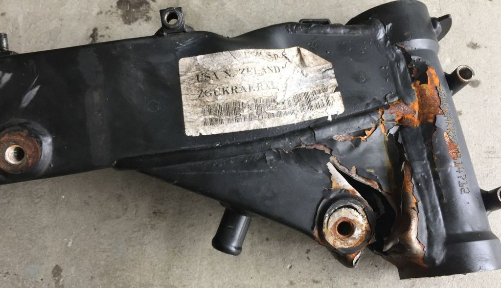

Scud Posted October 18, 2015 Author Posted October 18, 2015 I broke a few sub-assemblies into their final components today, including splitting the engine and transmission and getting a look at the dual-plate clutch and flywheel that was one of the main drivers for this project. An observation - just to reinforce what has been stated many times on this forum - there sure appeared to be a lot dry (un-greased) assembly. So many things I took apart had inadequate grease, or none at all: swingarm pivots, shock mount bolts, shifter pivot, driveshaft, I could go on......... The frame has no value to me. But I noticed that these spine-frames are welded together in the center. The back half is in great condition (everything came off easily), and here is a closeup of the damage to the front. It hit so hard that the top and bottom of the steering head went oblong; the head-bearing races just fell out after I got the (bent) steering stem out. If it has value to anyone (perhaps for some type of custom project), I'd gladly send it to you for the cost of shipping. If it's trash, please advise.
