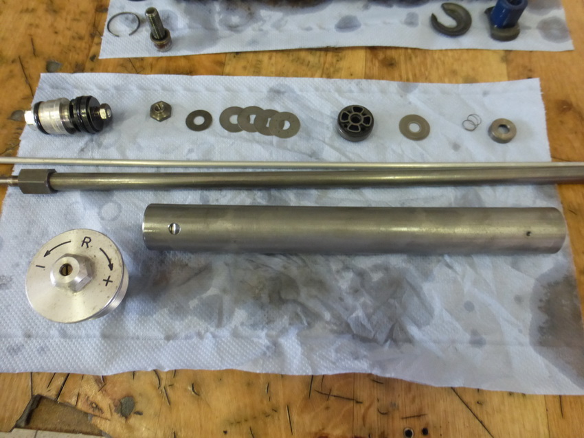

knumbnutz Posted October 24, 2016 Author Posted October 24, 2016 DSC_0181 by Neil Morgan, on Flickr DSC_0188 by Neil Morgan, on Flickr DSC_0189 by Neil Morgan, on Flickr Fork tubes are de-anodised and polished. I am unsure at the moment whether to anodise them again since they look beautiful but will require a clean every now and again. They'll hold a clean polished finish easy enough though. Once I find out how much the fork bearings are I'll decide whether to re-anodise. Putting in thicker oil and filling a hole in the compression dampener has solved the dampening issue DSC_0161 by Neil Morgan, on Flickr

gelos Posted October 25, 2016 Posted October 25, 2016 Hi Neil, are you sure it is rebound cartridge on your photo? My fork has 3 holes on compression side catridge, rebound has none.
knumbnutz Posted October 25, 2016 Author Posted October 25, 2016 ah.. someone did read the post. Yes my mistake it is the compression im talking about not rebound On 10/25/2016 at 7:52 AM, gelos said: Hi Neil, are you sure it is rebound cartridge on your photo? My fork has 3 holes on compression side catridge, rebound has none. 1
