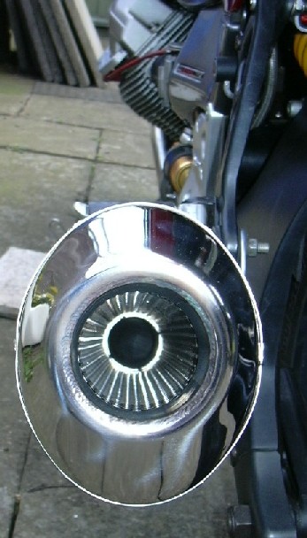

M4_3.JPGAs you can see there are no baffles in the cans !! :P
I made new hangers and a new X-over bracket using a car exhaust mount.

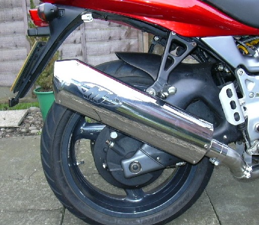

Pasotibbs:
Those look great! Have you also coated your headers? And who makes that rack for the tailpiece?
Pasotibbs:
Headers are just cleaned and polished up (scotchbrite,1200 wet and dry,and metal polish), the rack if I remember correctly is from http://www.motomeccaspares.com/ search for "Carrier V11 Sport Black"
there isn't a picture but I'm pretty sure thats the one.
