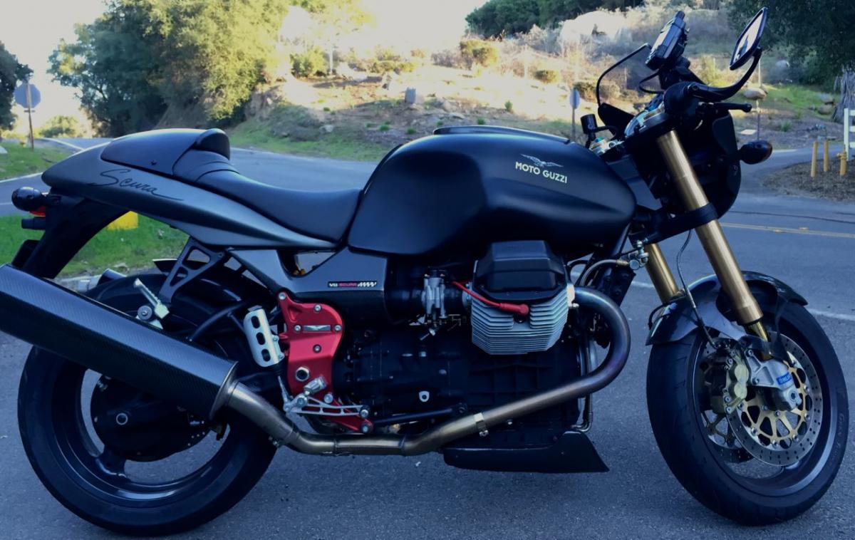

And here's the whole bike so far.
The next round of darkening will probably finish it off for me, and it will probably take a few weeks. Here's what I currently think needs to go for powdercoating (black, of course):

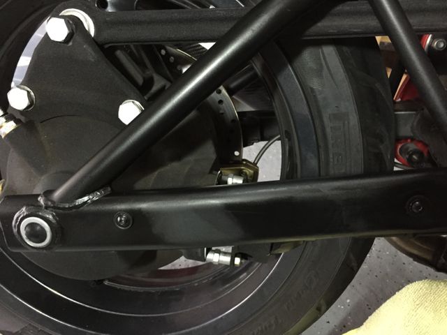

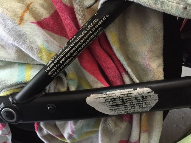

So I was trying to get the stickers off the swingarm and made a mistake. I started with "Turtle Wax Label and Sticker Remover" and a soft plastic scraper, then tried "Goof Off". It was tedious, and I damaged the finish on the swingarm.
Then I remembered that I own a heat gun...  :homer:
The heated stickers peeled away easily and left no residue. I don't know what's in those stickers, but a piece fell on the garage floor and stuck so hard that I had to heat it again to get it off.  I hope this can save somebody else some trouble. The stickers just say stuff that's easier to read in the manual or that doing other stuff is illegal... blah, blah, blah... Heck, putting this bike in 6th gear in illegal in the US.
I'm glad I started with the lower one; the damage isn't obvious with the exhaust canister back on (and the flash made it look worse). But those bolt heads are blinding...  :sun:
Haha, I did my swingarm a few days ago as well.
I bought a jeep a few years ago that was plastered with stickers….I used your method #1 and made a big mess and took 4 hours.
On my Guzzi however, I used my Harbor Freight heat gun, and peeled them right off. I have the Quat-D exhaust, so the swingarm is 100% visible. I couldn’t stand looking at those stickers anymore. I did however take some close up pictures for reference, just in case I forget those very important warnings!  :grin:

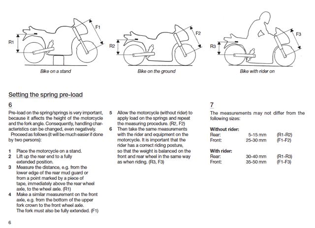

Since I'm going to be in there for the oil, this would be the time to pop in some springs if needed.  So I figured I should measure the spring pre-load to see if it's already in spec for me. I used the Ohlins manuals from the Fileshare section of this forum as a guide. Here's what I found:
Rear Shock:
R1-R2 = 14mm. This is sag WITHOUT rider. The target is 5-15mm
R1-R3 = 30mm. This is sag WITH rider. The target is 30-40mm
My conclusion: rear spring seems OK for me.
Front Fork:
F1-F2 = 41mm. This is sag WITHOUT rider. The target is 25-30mm
F1-F3 = 56mm. This is sag WITH rider. The target is 35-50mm
  • Action attempted based on my understanding of the Ohlins manual:  turn hex nuts on top of forks counter-clockwise 11 full rotations (out of 18 possible) to bring it within range for F1-F2.
  • Intrusion of reality:  the nuts were already turned to the stop in that direction - but could be freely turned the other way (and back to the stop).
  • My conclusion:  the bike does, as has been stated many times in this forum, need stiffer springs. In fact, it is impossible to set the preload within range WITHOUT the rider.

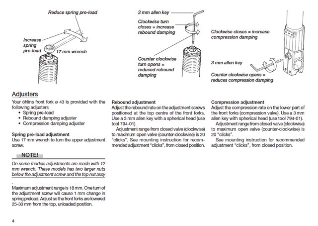

For ease of reference, and to take the guess-work out of the equation, here are the two relevant pages of the owners manual for Öhlins road & track front fork FG 43.
Screen Shot 2015-01-03 at 5.30.17 PM.jpg  Screen Shot 2015-01-03 at 5.35.16 PM.jpg

Any chance the manual has a typo? Easy to test. It beggars belief that out of the box isn't adjustable from completely out of proscribed range.
Scura forks: Turn top adjuster nut clockwise to increase spring preload. Turn nut counter-clockwise to reduce preload. Dunno what's with that manual.

Thanks Zooter and Baldini.  I don't have a helper right now - but I measured the height at rest on the sidestand, then turned both nuts 11 turns clockwise and measured again. It increased the height by 12mm - which is enough to bring pre-load within specs. It feels like the front and rear both compress at the same rate when I sit on it - whereas before it was obvious that the front sagged a lot more. I didn't want to believe that the Öhlins manual was incorrect.
