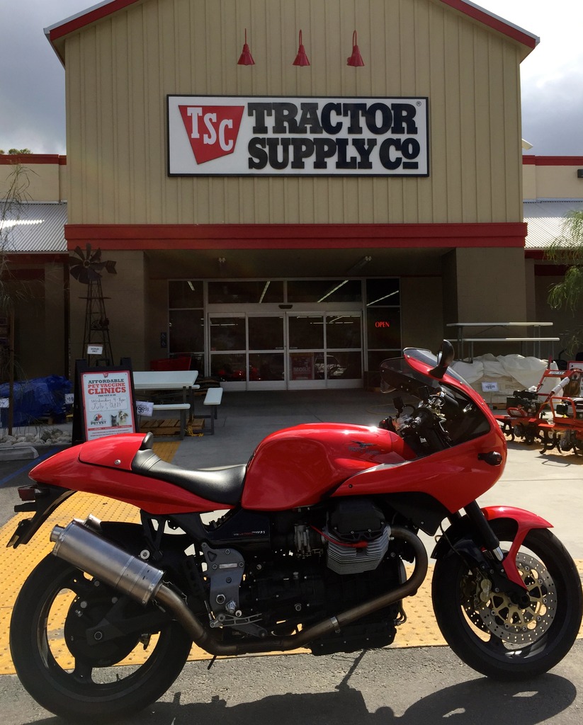

I stopped by the local dealer today...  :grin:
