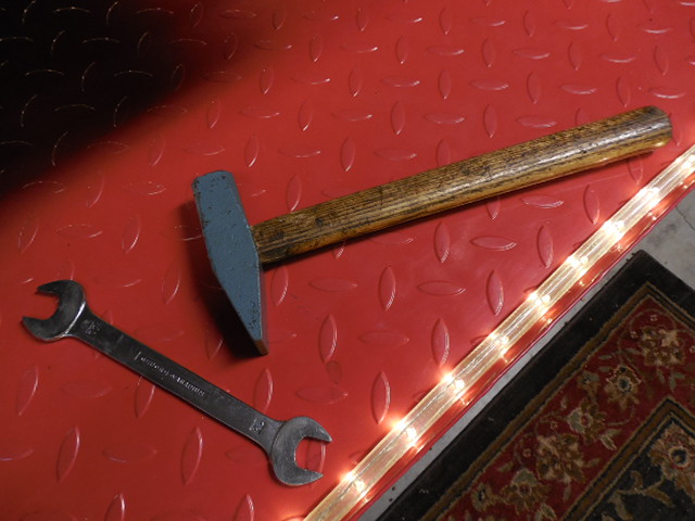

docc Posted March 4, 2014 Posted March 4, 2014 Bjorn, I hate to be one to point this out, but . . . there is at least one hammer in every one of your posts.
docc Posted March 9, 2014 Posted March 9, 2014 On 3/5/2014 at 2:54 PM, Bjorn said: Haha, nothing you cant fix with a hammer Especially a very good hammer! With what looks like, in your pictures, tools of Gedore-Vanadium!

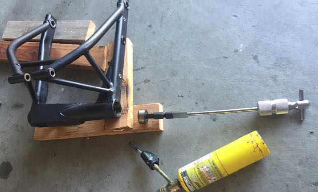

Scud Posted September 12, 2016 Posted September 12, 2016 Reviving thread after a couple years dormancy... I was almost discouraged from even trying to remove the swingarm bearings by reading this thread - and I'm posting to say it can be done. I was able to get the bearings out with heat on the swingarm (not directly to bearing) and a slide hammer that I bought today at Harbor Freight. There was absolutely no movement without heat. After I applied heat they came out with about 20 impacts. I did bend the slide hammer shaft - so I'm taking it back tomorrow for a refund. I will buy a higher quality tool next time I need one. I'm going to take the swingarm in for powdercoating.
moto fugazzi Posted October 12, 2016 Posted October 12, 2016 How did you bend the slide hammer shaft, Hercules? Let us know your trick of installing the new bearings. Ken
Scud Posted October 12, 2016 Posted October 12, 2016 I fault the cheap Harbor Freight tool for the bend, and do not credit my herculean strength. I froze the swingarm bearings (to shrink them) and set the swingarm in the sun to heat it up a bit (probably not hot enough to expand it, but that was my theory). I also used some very fine sandpaper to smooth out the bores where the bearings needed to go - I could feel a few small rough spots, which I assume were due to friction on removal and/or sandblasting. Then I used one of the old bearings as a bearing-driver to hammer the bearings in. You have to keep looking to make sure the bearings are going in straight - and adjust the hammer-strikes to level them out if they start to tilt. And have a soft surface underneath - like a block of wood covered with a towel - so you don't mess up your fresh powdercoat. Just as I got the first bearing started, a neighbor dropped by, wanted to chat. I said - frozen bearing, hot swingarm, please wait. Once that bearing starts to heat up, it will expand - so drive it in briskly.
