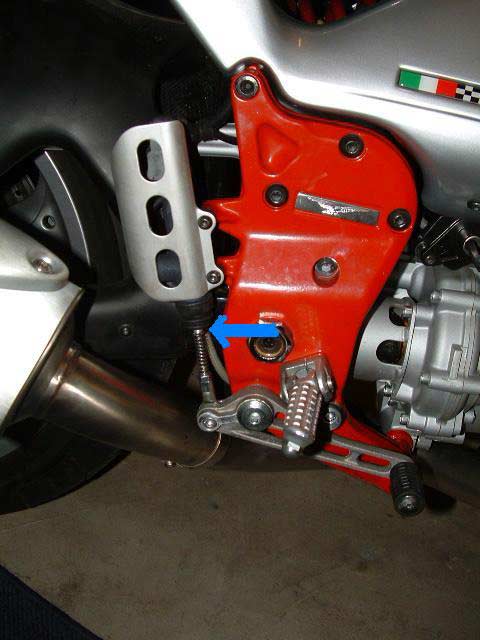

Lex Posted July 5, 2003 Share Posted July 5, 2003 Based on a problem much like what dkgross reported but not as severe (I got home) I added a spring to push the brake push rod away from the master cylinder piston. I had the rear wheel of my brand new RD 400 Yamaha lock up at about 40 MPH from this type of problem, I really do not want to experience that again. To make the spring work I had to add a tube that runs down the brake push rod from the master cylinder to just below the rubber boot. I put washers on each end (chrome on the bottom to match the push rod) to be sure nothing slipped. The total cost was a 1.49 USD, that seems like a pretty cheap fix. I'm not sure if this will pass muster for the more astatically sensitive types but I think it looks find. See attached picture. Link to comment Share on other sites More sharing options...
