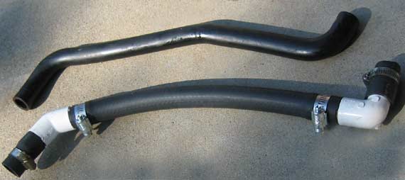

dlaing Posted September 22, 2003 Author Share Posted September 22, 2003 Yah Rich, the copper is just a little too small, while the outside of the half inch schedule 40 PVC pipe is a perfect fit. So what you need is 3/4 inch or 19mm Inner Diameter heater hose, a total of four hose clamps, a few inches of the 1/2 inch pvc pipe, and two pvc elbow connectors. I used one 45 degree angle connector at the bottom and a 90 degree angle connector at the top. Arrangements with variations of 45 and 90 degrees will work. You will need to PVC cement in the 1/2 inch pipe to all ends of the connectors. (unless you find connectors with male fittings. The 90 degree angle at the top fit pretty snub against the coils. A tight fit, but it works. Getting to the hose is not as difficult as it looks. Just take the fuel tank off, loosen up the coils (no need to remove the coils), loosen the hose clamps, yank off the hose, and reinstall the new hose assembly. My hose started cracking at the upper bend just above the coils, so be sure to inspect it there. EDIT Read to the end of this thread. there are problems with the PVC pipe, and better solutions available. Link to comment Share on other sites More sharing options...

RichMaund Posted September 22, 2003 Share Posted September 22, 2003 Looks much like the one I made for myself! But I didn't like the white PVC fittings showing, so I dabbed black liquid vinyl over them. Mine cracked above the coils as well. Any chance the coils produce ozone or something to rot the hose out? Link to comment Share on other sites More sharing options...
al_roethlisberger Posted September 22, 2003 Share Posted September 22, 2003 Dunno about the coils->ozone but there is a lot of heat in that area, and the bend probably gets some torsional movement/stresses as the engine revs, etc... so... Maybe it's just a function of it's location... BTW, this is a great solution. But here's a comment... can one find some sort of "clip" clamp like is often used on fuel injection lines that is less obtrusive than the spiral hose clamps in the photo above? I would assume so, but I've not found any easily. I just hate using spiral clamps for something that rarely if ever gets taken off(like the joints in this kit) and the darned things end up cutting you(or hoses/wires) with their damned razor-sharp tongues sticking out after tightening So I'd like to minimize the number I have employed under the tank... and I already have quite a few I'll have to check my "Summit Racing" catalog and local BMW dealership for such an animal methinks al Link to comment Share on other sites More sharing options...
