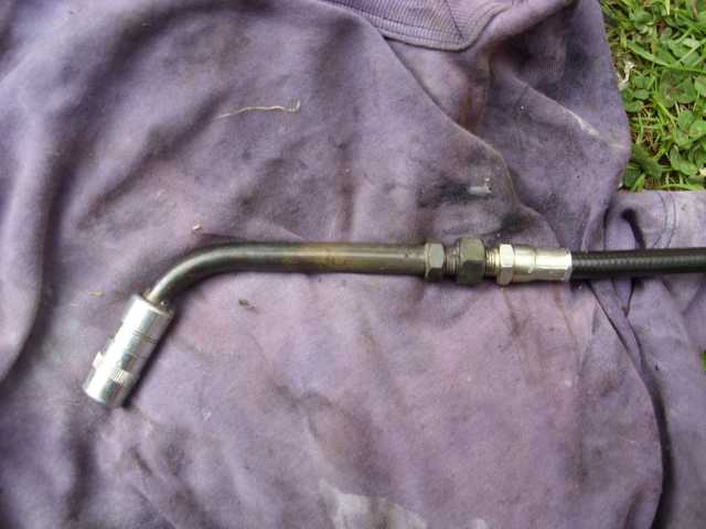

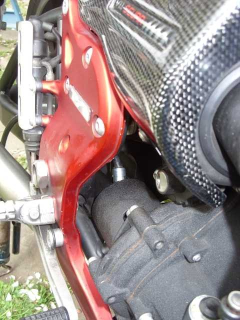

moscowphil Posted May 24, 2008 Posted May 24, 2008 Finally got round to tackling greasing the front uj. Turns out it's easy if you have the right attachment on your grease gun. All you have to do is: (1) Put bike on side stand. Stand back and admire it. Say nice things to it - it's much more likely to let you get access to its grease nipples that way.... (2) Reach over the top of the guard covering the uj from the front, and you will be able to feel the back end of the uj with your fingers. Feel around for the grease nipple - if you can't find it, move the bike slightly forwards or back to rotate the uj. The idea is to get the grease nipple sticking up vertically into the oval tunnel in the swing-arm. (3) Push the grease gun attachment through the swing-arm tunnel from the back, and guide it onto the grease nipple using your fingers from front. You will know when it's gone on, as it clicks into place. (4) Pump away. (5) That's it - no dismantling at all, and you can do it with the bike on its side-stand. Of course there's a catch - you have to have the right attachment for your grease gun - it has to have an angle of about 55 degrees as close to the connector as possible, to clear the swing-arm tunnel. A flexible attachment won't do it (I tried), and I don't think a 45 degree attachment will do it either. But the solution's simple - make you own 55 degree attachment. I just took a standard straight attachment, heated it red hot in the fire and bent it. Here's a pic: And here's another of it on the grease nipple: You can see I've also included a length of flexible hose between the grease gun and my 55 degree fitting, so that the body of the gun doesn't get tangled up with the swing-arm.

moscowphil Posted June 2, 2008 Author Posted June 2, 2008 Wheel is still on ! ? Yes, I didn't have to take anything off at all. I had already ditched the hugger mind, but I don't think that would get in the way. I've posted something in the other thread that's running about this topic, which explains how I made the fitting for my grease gun. It took me a couple of hours , but worth it in the long run.

moscowphil Posted June 2, 2008 Author Posted June 2, 2008 I might sound dumb and i havent read the other tread but u cant get to the zerk with a flex hose on the gun? I tried with a flexi-hose, but no success. The problem is that the flexi hose has a rigid metal bit at each end, which means you can't get the bend close enough to the coupler. The bend needs to be as close to the coupler as possible, so that it will clear the swing arm tunnel.
John in Leeds Posted June 2, 2008 Posted June 2, 2008 I can get straight on through the tunnel with a flexy (wheel off). It is tight however and I don't want to break the grease nipple (zerk) when I pull it off. What is required is a 45 degree angle connector. The bend closer to the connection end the better. I'll try and make one up, seems everyone could do with one and save so much hassle.
