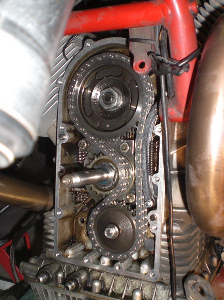

Kiwi_Roy Posted June 18, 2012 Posted June 18, 2012 I decided to change the timing chain and tensioner, I purchased one from MG Cycle When I pulled the old one out it's hard to see how the new one will fit in its place. Can anyone please confirm if is right or wrong. Thanks Roy Old one at the top New one at the bottom
AndyH Posted June 18, 2012 Posted June 18, 2012 I decided to change the timing chain and tensioner, I purchased one from MG Cycle When I pulled the old one out it's hard to see how the new one will fit in its place. Can anyone please confirm if is right or wrong. Thanks Roy Old one at the top New one at the bottom I was wondering about how that fitted too, so I held off getting one. Would be interested to hear the answer. Andy
Admin Jaap Posted June 18, 2012 Posted June 18, 2012 Fitted one in my Centauro engine. Fits w/o problems and works too as far as I can see. Not tested yet, but if they wouldn't work right, I dont think they'd be still up for sale. Here's a pic (not mine btw)

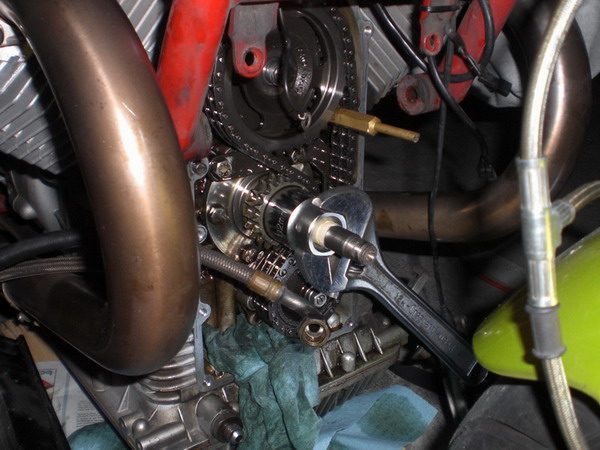

Kiwi_Roy Posted June 18, 2012 Author Posted June 18, 2012 Fitted one in my Centauro engine. Fits w/o problems and works too as far as I can see. Not tested yet, but if they wouldn't work right, I dont think they'd be still up for sale. Here's a pic (not mine btw) Thanks Jaap, I was worried perhaps the tensioner was intended for a different engine. On first sight the original looked OK but I was able to push it to the case and it would sometimes stay there. All I have to do now is figure out how to get the nut off the crankshaft Update, A 3/4" drive 32mm socket fits over the shaft. I ground a couple of flats on it and spun it off with a 12" Crescent wrench. Wrap a couple of turns of masking tape over the shaft to protect it. What was I doing wrong there?
AndyH Posted June 18, 2012 Posted June 18, 2012 Fitted one in my Centauro engine. Fits w/o problems and works too as far as I can see. Not tested yet, but if they wouldn't work right, I dont think they'd be still up for sale. Here's a pic (not mine btw) You wouldn't think there was room if it wasn't there in technicolor! I was thinking this would be a sensible mod for a road rider like me, but how does this compare to a timing gear set:, has anyone tried them? Spur vs straight cut, steel vs alloy etc etc.? So many options... they're expensive but are they worth it to anyone not racing or outright performance hungry? Andy
Kiwi_Roy Posted June 20, 2012 Author Posted June 20, 2012 All back together. No - I didn't jamb a brass drift in the chain to tighten the nuts, I did to remove them because I was replacing the chain anyway. To tighten I put the bike in top gear and foot on the brake. I can't believe how crude the OEM tensioner is compared to the one from MG Cycle. Hopefully it will cure the sneeze Because the original bolts are too long to simply screw back in without the bracket I hacked it off and scratched on a message for the next caretaker Many thanks to Carl for pointing to the upgrade and Jaap for the picture of one installed Roy
