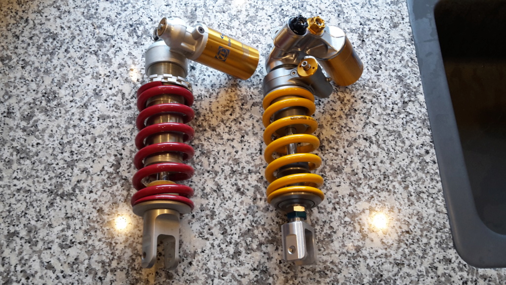

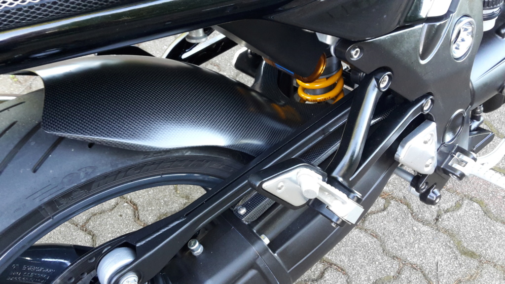

biesel Posted June 21, 2018 Posted June 21, 2018 I have mounted an Öhlins TTX 36 shock and a Millepercento Fender/Mud guard on my Griso.Expensive but really excellent products which I can really recommend.I have just uploaded a slideshow to my YouTube channel showing the whole procedure:https://www.youtube.com/watch?v=Hi8Lw80TpOo 2

not-fishing Posted June 24, 2018 Posted June 24, 2018 Ach du lieber himmel! Your Griso is so clean! Mine, on the other hand looks like a proper raufbold. It's all grimy after 50,000+ miles. Thanks for the post it's getting close to time for me to replace the rear shock. 1

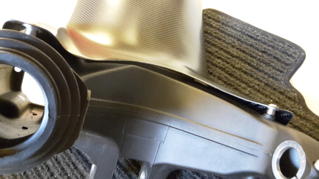

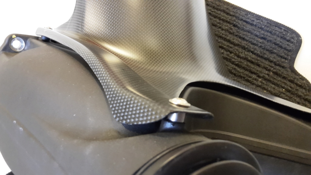

68C Posted July 2, 2018 Posted July 2, 2018 I have mounted an Öhlins TTX 36 shock and a Millepercento Fender/Mud guard on my Griso. Expensive but really excellent products which I can really recommend. I have just uploaded a slideshow to my YouTube channel showing the whole procedure:https://www.youtube.com/watch?v=Hi8Lw80TpOo I know I keep on about this but....... Remember carbon fibre is not fibreglass or plastic. It conducts eletricity and so will cause galvanic corrosion if water gets between it and metal, in particular aluminium alloy. Not a problem provided you make sure there is no bare alloy to carbon fibre contact. When I picked up my Rosso Corsa and gave it a good clean I found the lugs on the Ohlins forks were very pitted with corrosion. Cleaned up OK and now insulated with plenty of paint on the lugs and plastic washers. You just paid a lot of money for those lovely parts, make sure they will last. 2

biesel Posted July 5, 2018 Author Posted July 5, 2018 @68C: Thanks for this hint. I wasn´t aware of this but you are right (had to google for this)! The spacers between fender and swingarm should help to avoid this. 1
