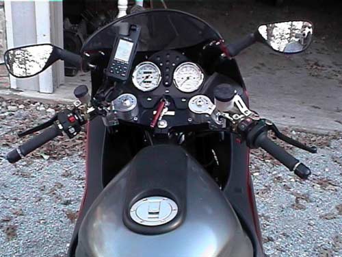

Guest russ Posted November 16, 2002 Posted November 16, 2002 OK boys (and Girls), the Verlicchi's are on. I took a pic but it was somewhat dark, hope you can make it out. These bars will give me what I am looking for, especially with the seat Rich is doing for me (as we speak) and the peg relo kit. Easy install and the bar end weights work well since the bars were tapped. Just unbolt, raise fork legs about 5/8" and bolt it all together. Adjustments are limited unless you want to get new Hydraulic lines, but I think the allowable movement is enough. The fairing will block any extreme movement anyway. The Bars also allow for some room to use my RAM Mount for my GPS (I love gadgets)! I'll let you know how it rides when I get my seat back next week!
Guest JohnInNH Posted November 16, 2002 Posted November 16, 2002 Russ, After I lightened up the photo I could see how you attached the bars. I looks like you clamped them on top of the triple tree. Do you know if the legs were raised in the clamps? Thus lowering the front end. I was under the impression they were supposed to go UNDER the top plate. Would you tell us about how much UP and BACK you could get the bars before being limited by the break and clutch lines. Thanks... John
Guest russ Posted November 17, 2002 Posted November 17, 2002 John, First of all thanks for lightening the photo. I spoke with Gordon at MG (where I bought them) and while discussing it I mentioned to him that I would have to raise the legs about 3/4" over the stock clamps which are also above. He seemed to think that it would make no difference in the handling, which I will verify as soon as I get my seat back from Rich Maund (mid week). It certainly seems like a very minor change and if it affects the handling I would bet that stiffening up the front end via the compression and rebound adjustments would compensate. As for the bar travel it was not a huge amount. I am guessing about an inch or so back and maybe two inches up. The limiting factor being the hydraulic lines. It seems though, that this will be a vast improvement because the bars are also a little wider and do not droop as much as the stockers. Just sitting on the bike it is much more comfortable. I would doubt that too much more adjustability will be available anyway due to the fairing. I'll get a better pic out once the seat comes back and I get a riding impression.
Guest russ Posted November 20, 2002 Posted November 20, 2002 Had my first ride with the clips today. Better than stock but I think a few more adjustments are in order. I am afraid that I might not be able to adjust enough w/o replacing the hydraulic lines which I don't want to do if I can avoid it. I think these will work well once fine tuned! Pic attached. Also note the new Rich Maund Seat and the GPS setup.
