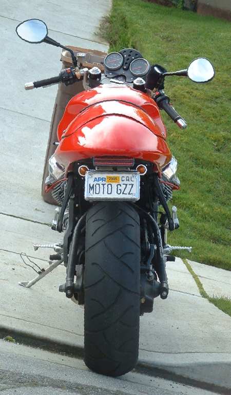

F344 Posted January 14, 2005 Posted January 14, 2005 Hi Guys, A buddy of mine has reworked my exhaust system for me. If you want to hear it, I've posted a .wmv file at http://www.frankschaffer.name/V11%20modded%20cans.wmv Frank

F344 Posted January 15, 2005 Author Posted January 15, 2005 Here are some before photos. For those of you that have expressed interest. The guy that did this for me is named Enzo Fatica, his email is: enzometalmania@sbcglobal.net He said if you email him to be sure and mention Moto Guzzi in the subject line so he knows it isn't spam. He'll need the bike at his shop in San Francisco. He had my bike for about 6 days, but he has a regular job, so you will have to see what his schedule allows. For "dlaing", I'll be in and out all day tomorrow, you can call me at 650 344 0637 if you want to come by. I am giving Enzo my salt water aquarium and we'll be moving back and forth between his place in the city and my house in Burlingame most of the day, so setting up a time shouldn't be a problem. Frank

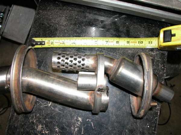

F344 Posted January 15, 2005 Author Posted January 15, 2005 Hi Al, It will be a year or so before we can draw any conclusions about vibration and weld integrity, but I'll keep you guys posted. This bike is a 2003 with the forward x-over, but I did lose the rear cross over. Eventually, I'm going to ride the bike down to Moto Italianio's new store and let them ride it, they can best judge the performance, but from just 20 or so miles I can say the ridability seem fine. I regarding the pricing, there was a lot of cutting and fitting to make it snug up as high as he could get it, so I doubt it will be cheaper than all the other exhaust options. After waiting 8 months for MG Ti cans, I gave up and went with this. Actually I was going to have him make up something like that box that you can get from Italy. But he suggested this. All the welding is done in steel and then the aluminum sleeves and slotted, cut down and remounted. I’ll attach a couple more photos. Frank That looks awesome , but I have two concerns: 1) These bikes seem to perform better with a 2:1 or at least "crossed over" system. So especially for those that do not have any front crossover(2002 and earlier), there may be some performance hit, although that is just an assumption. 2) We've seen quite a few exhausts, even the OEM units, shake themselves apart by cracking at the welds. It's hard to tell much from the photo, but I would suggest a *very* beefy bracket for mounting these cans, especially since the shell of the cans are aluminum... assuming it is welded to the aluminum shell. Anyway, point 1 is easily researched, and point 2 is just something to consider with regard to improving durability, if your guy hasn't already Again, great work though. I had thought about this a while back, and I'm glad to see someone executed on it, as it looks really great. ...will be curious to see the ongoing pricing for this conversion, and long(ish)-term performance/durability results. Excellent work al 41060[/snapback]
F344 Posted January 15, 2005 Author Posted January 15, 2005 This is what I had in mind before enzo suggested cutting the cans down. Obviously his idea was much better. Frank
