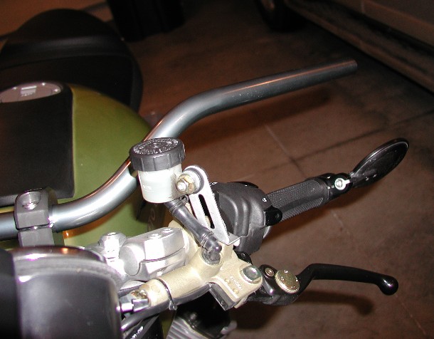

I was quoted $650 for the Moto Guzzi parts to complete the Ballabio conversion so I put the idea on the back burner until I found a good deal on a set of LSL L02 bars and Oberon long risers on ebay. After the successful transaction, I received the parts in the mail and checked the fit – about 3” to 4” up and about 3” to 4” back. This was a little higher than I wanted, but I had the parts so I plowed forward.

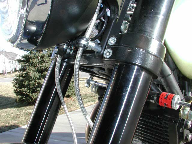

4. For expediency, I elected to have custom hydraulic lines made.
a. I used Galfer components since that is what my dealer had.
b. The front brake could be a “T’ line similar to stock, a single line with a line connecting the calipers, or a dual line system. I used the dual line system due to its simplicity. There were still several issues:
i. My lines ended up being approximately 28” and 30.5” long – not including the banjo fittings.
ii. I used to one straight fitting and one 45 deg banjo fitting at the lever because parallel 45’s didn’t fit.
iii. I needed extra thick 10 mm crush washers from my local auto parts store because the Galfer double banjo bolt at the brake lever was a little long.
iv. I used longer lower headlight bracket mounting bolts with spacers and 3/8” electrical wiring clamps for the brake line guides – see pics.

6. I reamed out the aluminum bars and tapped them with an 18mm tap so the stock bar ends would work. I had to remove the stock rubber pieces from the bar ends and replace these pieces with less thick tubing so the dampers would slide into the new bars.

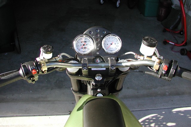

I’ve only ridden about sixty miles with the new bars, so I have not finalized my opinion on the new ergonomics. The riding position is similar to a ZX1200 or a Bandit 1200 - very comfortable. Almost comfortable enough to make my bike feel slower, well maybe not slower but certainly less racy. I’m going to ride a couple hundred more miles before I do anything, but I may change to the LSL L01 bars with slightly less rise and pull back.
Then again, the low speed control is improved and if one is inclined toward any hooligan type antics the new set up is ideal with its more dirtbike type layout. After a little acclimation, I may really like the new set up.
