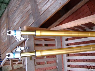

Guest PAULSMART Posted July 3, 2006 Posted July 3, 2006 to all you technical guys, is it possible to fit the Ohlins off a latter V11, TO A 2000 model. Is it just a case of swapping various parts, or a complex nightmare of engineering spacers etc.. Paul
Admin Jaap Posted July 3, 2006 Posted July 3, 2006 Paul, read the infamous hollow axle thread. Click here.
Guest PAULSMART Posted July 3, 2006 Posted July 3, 2006 hmmmmm!!! right - I think I'll scrap that idea!!! and watch the telly instead... Perhaps have standard forks revalved or something. Ebay have 04 V11 Ohlins for sale here in UK, so an idea was sown, and now cancelled. thanks Jaap, Paul
Admin Jaap Posted July 3, 2006 Posted July 3, 2006 It's not that difficult. Just order a Duc 999 front axle and change the front wheel bearings. Believe me, the Öhlins are worth the trouble!
dlaing Posted July 3, 2006 Posted July 3, 2006 hmmmmm!!! right - I think I'll scrap that idea!!! and watch the telly instead... 93964[/snapback] I think that thread makes it look far more difficult than it is. All you need is: 1)Fender from Guzzi with Ohlins (solid or hollow axle does not effect fender) Paul M. mentioned this fender http://www.motorradparts-lehner.de/ Kotflügel vorne Carbon RSV001 102,00 € 2)Ducati 999 front hollow spindle/axle: ducati part number 819.1.043.1A 3)Ducati 999 spindle nut: 748.1.014.1A 4)Ducati 999 washer: 8000.70119 Or you could go with Guzzi equivalent axle parts...that the thread indicates may be cheaper. 5)One approximately ~104mm long spacer for the space between the bearings in the wheel You will probably need measure the space between the bearing, add 0.5mm and hav a machinist cut a tube to exactly that length. Your existing bearing spacer should be the right length, but the wrong Inner Diameter. Spacer ID must be just a little more than 25mm...1inch ID is about perfect. Tubing should be hard enough not to distort under torque. 6)One bearing, 52x25x15mm == 6205 - 2rs_ (you might as well get two bearings, just to start fresh. For me the process was easy because Mike Stewart bought and made everything I needed.

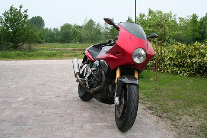

antonio carroccio Posted July 4, 2006 Posted July 4, 2006 as an option you can fix the front wheelcover from Aprilia. Like I did.

Paul Minnaert Posted September 8, 2006 Posted September 8, 2006 as an option you can fix the front wheelcover from Aprilia. Like I did. Yes omly it's mounted wrong, because you have the one from the rsv factory, it's to high at the back. So change the back mounting

Guzzirider Posted September 8, 2006 Posted September 8, 2006 If you want some new Ohilins then the German guy who bought all the V11 spares is selling them for about the equivalent of £900. I am tremoving Helen's forks next week and taking them to Maxton- this is a clip from their email to me explaining what they are going to do: We throw everything inside the forks away and start again with our own Maxton cartridges. This conversion also replaces the fork tops with out own Maxton forks tops that are adjustable for rebound damping and preload. The Maxton cartridges have rebound damping and compression damping in both legs and have springs fitted to suit you rider weight. The cartridge conversion costs £380.00 + V.A.T, this includes new forks seals. If you sent thee forks to us at the moment it would take about 2 to 3 weeks to convert the forks. Its quite pricey but their reputation is excellent and I know from others who have had their forks modded by Maxton that Helen will be very pleased with the end result, and still quite a saving on Ohlins. Guy
Greg Field Posted September 9, 2006 Posted September 9, 2006 Yes omly it's mounted wrong, because you have the one from the rsv factory, it's to high at the back. So change the back mounting I just got Ohlins for Billy Bob (from a Cafe Sport) and was thinking of usng an Aprilia fender. It looks as if the one from the 00-03 Mille R would fit perfectly. Is this correct?
