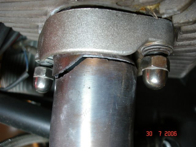

Bill Hagan Posted July 30, 2006 Share Posted July 30, 2006 Developed a pronounced backfire on decel during docc's great ride in the Tennessee and N.C. mountains last weekend. http://www.v11lemans.com/forums/index.php?...ic=7421&hl= Hmmmmm. Usually, that means an exhaust leak, but none to befound. Well, on trying to fix my ad nauseum harmonic vibration, I tried loosening all exhaust fasteners. Whoa! What's this? See what I found on exposing the left-side exhaust-header pipe. Yikes! Link to comment Share on other sites More sharing options...
Guzzirider Posted July 30, 2006 Share Posted July 30, 2006 This has happened to mine, and also Martin and Mal's bikes too. Easy enough to get welded if you don't want to buy a new pipe. Guy Link to comment Share on other sites More sharing options...
Guest ratchethack Posted July 30, 2006 Share Posted July 30, 2006 Bill, this happened to my Pal's '04 LM also. As I recall, you'd been running with a coathanger wire supporting y'er crossover? FWIW, not having a correct support installed with his Stucchi crossover, even though the Stucchi has a provision for it, is what broke my Pal's in the same place. He had the cracks welded and installed the stock rubber hanger, and all's been well since. Link to comment Share on other sites More sharing options...
droydx Posted July 30, 2006 Share Posted July 30, 2006 The same thing happened on the left side pipe on my 03 Rosso, luckily replaced under warranty. I think the mandrel that they bent the lefties on had a burr or something and left a stressed area on a lot of the pipes....many cracked lefts, few rights. ? Link to comment Share on other sites More sharing options...

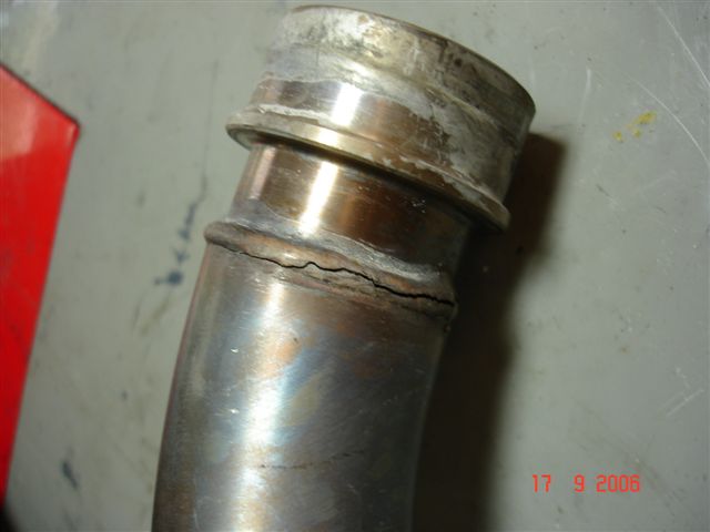

Bill Hagan Posted August 14, 2006 Author Share Posted August 14, 2006 Check out the "a professional welder did that?" shots as opposed to the fix by Ray Clay. Ray welds stainless steel every day: he specializes in whatever you call those teat & cow udders things. Burrs are a bad thing in that business! http://snipurl.com/uxks Now, it's out to the GarageMahalo to see if I can put it all back together. Link to comment Share on other sites More sharing options...

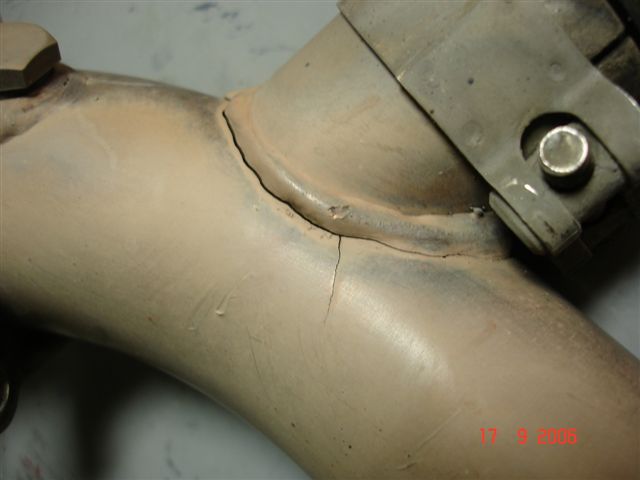

Bill Hagan Posted September 18, 2006 Author Share Posted September 18, 2006 Check out the "a professional welder did that?" shots as opposed to the fix by Ray Clay. Ray welds stainless steel every day: he specializes in whatever you call those teat & cow udders things. Burrs are a bad thing in that business! http://snipurl.com/uxks Now, it's out to the GarageMahalo to see if I can put it all back together. Well, here we go again ... As you may recall, had the right-side crack fixed. On way back from 2K-miler over Labor Day weekend, noted the classic "you've got an exhaust leak" backfiring. Weighed down with some "eldercare" issues, finally had time this past weekend to look more closely. & The whole set-up must be too rigid. In fact, as grateful I was for the shim "fix" (and it certainly did fix the "flop") I cannot help but wonder if putting up with flopping around a bit would not be preferable. 'Course, that may not be the real culprit, but rigidity somewhere seems to be the issue. If the gaskets are available, I might buy a case. Also noted that the forward end of the left side of crossover is up agains the engine case and its leading edge is gouging it. Wonder if--assuming as is, I think, the case, the crossover can't be nudged a bit to the left--it might be possible to slip some flat metal barrier in there. Hmmmmm. And, OBTW, check out the pic of my Pilot Power, with only 2K miles on it. Sigh. Not sure when I picked those up, but I'm starting to feel paranoid about nails. Link to comment Share on other sites More sharing options...
