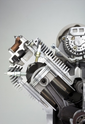

Guest brucev11 Posted September 7, 2006 Share Posted September 7, 2006 OK, some o' you Guzzi cylinder head experts. I've not had the heads off. I'd like to get an accurate read on the stock squish setting that comes from Mandello. I've got .084" solder, and can't get a "clamp" between piston crown and cylinder head through the spark plug holes at TDC. In fact, it feels quite a bit looser than this. I was expecting a reading of something in the neighborhood of .060" to .080". Is this possible? Am I missing the squish band entirely with about 3 cm "hook" in the solder, pointing in the downward direction from the spark plug hole? If I'd ever seen the inside of the Guzzi cylinder head, I'd no doubt be able to explain this, but I'm literally flyin' blind here. Though I've been on the inside of a pile of SOHC and DOHC cylinder heads, I haven't had a hemi pushrod head off for over 30 years. The above doesn't fit my expectations. Anybody got an explanation? UPDATE: This gets curiouser and curiouser. I just tried .130" solder, and couldn't get a "clamp" with this either. . . . . Re the squish band , attached is a picture of the cylinder head 'cut away' . This may help in the 'fishing' with the solder. Link to comment Share on other sites More sharing options...
Guest ratchethack Posted September 7, 2006 Share Posted September 7, 2006 Re the squish band , attached is a picture of the cylinder head 'cut away' . This may help in the 'fishing' with the solder. Most helpful, indeedy, Bruce. This is one case where the photo is worth a thousand words. Many thanks! I assume the dual plug head dimensions are about the same as the single plug heads. I note that the outboard spark plug is exactly where I expected it to be relative to the combusion chamber, but no wonder I couldn't reach the squish band by going straight downward -- not only is it more of a stretch than I had imagined, it's also more of an acute angle to reach it than I'd expected. As Mike suggested, it's nearly a straight shot across to the other side. This is what I'll shoot for next. Strange that the inboard plug hole locates the electrodes closer to the centerline of the bore than the outboard one, and that it's also at a steeper angle relative to the bore. Different diameter plug -- no doubt different heat range also. Link to comment Share on other sites More sharing options...

motoguzznix Posted September 8, 2006 Share Posted September 8, 2006 Ratchet The shape of the V11 cylinder head is different to that on the picture sent by brucev11. I tried to draw that into the picture above. As you can see, the breva has the classic hemi with squish again. The V11 heads have a conical shape in the area from the cylinder bore to the hemispherical chamber. So there is only a small area of approx. 1 - 2 mm squish remaining on the ouside of the combustion chamber. Squish on my V11 was at 1,7 mm. You have to mill approx. 1mm off the heads to make the conical area disappear. Then the hemi area blends into the then larger squish area, which at my opinion makes a better combustion chamber design. When you further machine approx. 0,5 mm from the cylinders to bring the pistons to the top, you are 1,5 mm shorter with head and cylinders, so the pushrods should be shortened by the same amount, to prevent the valve train geometry getting asymmetric. Furthermore, the compression ratio raises and the valves come nearer to the pistons. Valve clearence has to be taken into account and the pockets in the pistons might have to be deeper. I would look for a CR not too much above 10:1 without twin spark. Unfortunately I am only half that way with my V11, but when I pull off my heads next time, all that will be done. Link to comment Share on other sites More sharing options...
