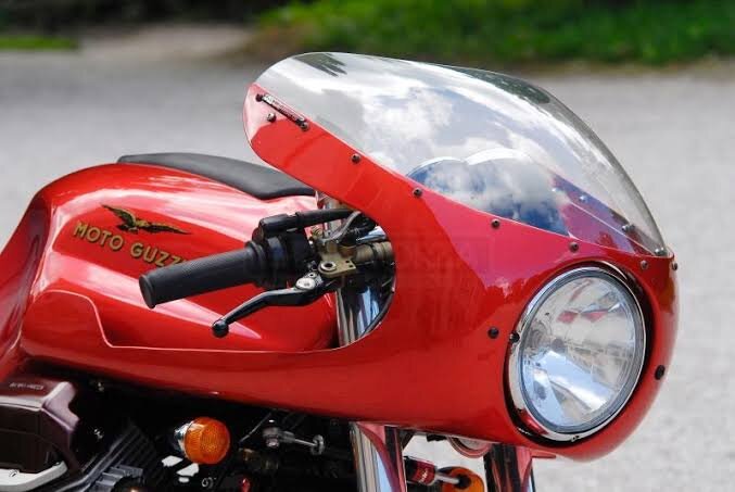

Isn't it exquisite! Anyways...... I was looking for answers that were not fully answered in the previous posts. My questions are: 1. If I bought a V11 Le Mans, would the existing headlight fairing mounts be usable with the Laverda fairing? 2. If so, what modifications would be required to make it work? (This is assuming anyone has done the fairing swap with a V11 LM. The bike in the pics is a Le Mans....) 3. If anyone has fitted this fairing on any other V11 using any other fairing/headlight mount, and if so what did they use? 4. Do all V11s have the mounting tabs (bolt tubes,) for a fairing on the headstock or only those that had an OEM fairing fitted? 5. If you have done it, step by step Photos would be great to help the rest of us who want to do the same. I promise, if I do it to my bike I will post videos and a step by step photo guide telling how it was done and any issues I had and how they were overcome. HELP!
I know this is an old post. Ressurrecting it, because now I am looking at doing a Laverda fairing on a V11 and some questions are unanswered and some photos are no longer visible..... Here is the bike that started the whole discussion....

Thanks for the advice guys. The pics I posted feature a Laverda SFC 750 fairing which I'd love to put on. Make the bike look longer and leaner. The fairing is Available for about 100 Euros from https://www.motoforzafairings.com/half-fairing-road-laverda-moto-guzzi-etc-laverda-sfc-750-1974 I have seen a Greenie in the flesh. 😍 I also like silver and could be happy with that. Still 😍 The only mods I'd do would be the fairing and maybe relocate the signals and put reverse cones on. Maybe tidy the tail.... wouldn't want to do more. Too damn near perfect stock.... Regarding the red valve covers that fade, arent they anodised? All the red anodised bits ive seen fade with uv exposure over time. Feast your eyes on this red beauty! Bob.
