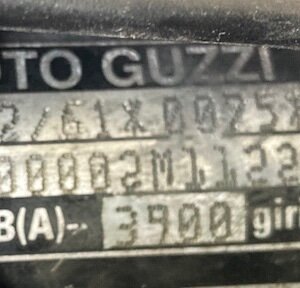

  13. HI Docc. Thanks. From the photo year of manufacture would seem to be 2002..which makes sense given it was first registered in the UK in March 2003. Does this tell me anything else I need to know? Thanks for your interest

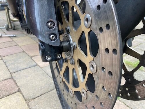

  14. Hello again fellow puzzle solvers. Thanks again for your interest and input. Docc. Yes my bike has a chin pad and white dials. The VIN number on the log book begins ZGUKS000.... which matches the numbers on the headstock. Im not sure how to decode the year of manufacture. The other long number begins e3*92/..... Weegie, LuckyPhil, 80CX100..You all seem to have this right in describing my set up which does fit with the diagram found on the Harpers site ..see above. 20mm bearing on RHS. 25mm on LHS. No nut, but axle spindle threads directly into left leg. Spindle passes through 25 mm drilling in RH fork leg, shoulder of spindle butts up against outer face of RH bearing. through inner sleeve which has an internal diameter of 20mm. and external diameter of 25mm, with a wider shoulder which butts against the inner side of the LH bearing. This inner sleeve protrudes about 13 mm through the LH bearing, the 15mm aluminium (int dia. 25mm) spacer slips over that, and butts up against the outer face of the LH bearing and the inner face of the LH fork leg. Everything tightens together when the spindle is torqued up with the 14mm hex allen key from the right. Two screws on the RH leg lock the spindle. This does seem an odd design to me too, partly because it is possible to assemble things incorrectly, as I have discovered. If I understand it correctly now it perhaps offers the advantage that both bearings inner races are supported on both their inner and outer faces......but the "whats in the parts bin this week?" also seems plausible? I'm just glad to have it all back together...new rubber and bearings, new shock (another story!) improved mud protection, and sundry other detailing points.

  17. Hi. Thanks for all your thoughts. In the process I think I had thunk it through, and it looks like the (odd) different sized bearings is correct. Just dug a but deeper on Harpers and found this which seems to fit with our combined deductions and what I actually have...no missing spacer pandemic! Down to the local bearing factors in the morning. Will report back and include some images for others who find themselves on this confusing path.
  18. I'm now pretty confident its the wrong bearing on the RH side. Will replace it and update this thread.
  19. Thanks 80CX100 What you say concurs with my own thinking ie the 25mm shoulder should sit against the outer edge of the RH bearing....if only I'd kept the originals. Here's a photo of the spacer.
  20. Oh heck. Next thing we know there'll be a pandemic missing spacers! Stewgnu...maybe. All the diagrams and everything I have seen so far says spacer on the left side. Ill post a clearer pic of my spacer. Thanks Chuck. I've looked at parts manuals that I have access to which don't show a second spacer. I have seen some talk of different sized internal dimensions for the wheel bearings (which seems a strange approach to me, but it would all tighten up properly. That would be a int. diameter of 20mm on the R/H side and 25mm on the L/H side as fitted now. the internal sleeve arrangement making up the difference. I must admit that I didn't check the new ones against the old (now long gone). Idiot. I was handed the new bearings at my last MOT on the understanding that I would fit them straight away! So the guy there may have just assumed a standard size. Thanks for all you thoughts
  21. Yes Thanks Gents. Yes Weegie, you analysis of the situation is bang on, and accounts for my confusion over this. The wider part of the axle bolt does indeed screw into the centre of the RHS bearing...so it can't be right the way that it is. Yes. Hoping someone who knows this set up will chip in...
  22. Hi. Thanks. The axle bolt is 25mm diameter at the R/H end and 20mm diameter at the left hand side. It threads directly into the left fork leg. The spacer has in internal diameter of 20mm and is about 15mm long, so will fit over the bigger R/H end of the axle, or (as I have it in the photo) over the inner sleeve that fits between the two (new) bearings, and protrudes through the L/H bearing. It is possible that I've mislaid something...or it was never there, but I'm usually pretty careful about stuff like this. Very puzzled. Would love to hear from someone with the same fork arrangement.
  23. Hi. New to posting but not to the forum. I have usually found advice and information to help with any issues I have had but this time I’m driving myself bonkers trying to sort out the simplest reassembly of the front wheel spindle. Ive read through tis and several other threads but don't seem to be able to find the complete answer. I have a 2003 cafe sport with black mazocchi forks and a spindle axle that threads directly into the left hand leg (ie no nut) with two clamp bolts on the right hand leg (from the riders point of view).The thing is I can’t see an order of assembly that makes complete sense unless I have mislaid a spacer. There seem to be quite a few different arrangements. Assembling the parts and tightening up as illustrated in the workshop manual results in the spacer seeming to be loose, and the head of the spindle deeper into the fork leg than I remember at disassembly. Can anyone advise me on this? Have I mislaid a second spacer?
