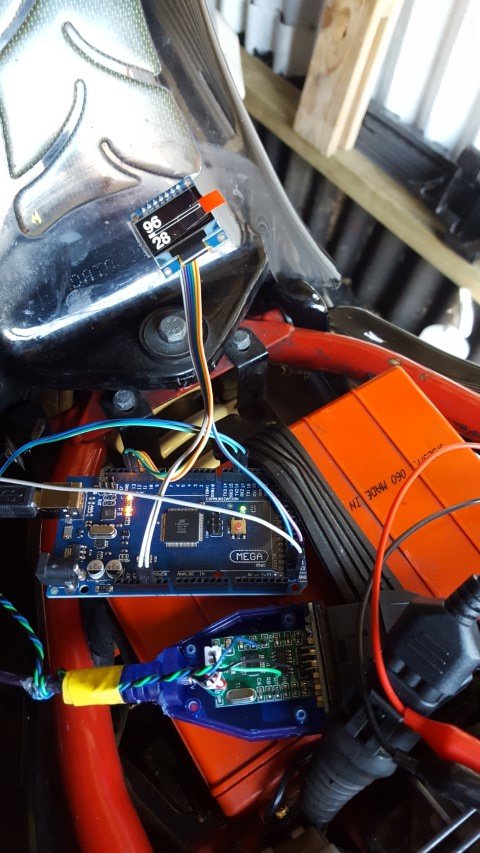

  2. And this is whats lurking under the seat...

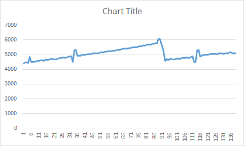

  3. Just for interest, this is a log of a gearchange: Speed is updated every second via GPS - hence the steps! There are some disturbances in the injector timings but hard to say if they match RPM glitches. The sample rate is too slow to be sure at only 15 times per second, but I have just improved that to 30 times per second, so it may show up better... When it drys up a bit outside, I'll take another plot and keep the bike in a lower gear to keep the rpms in the 5000-6000 band for longer. I'm actually looking for the reasons for the occasional missfire / hiccup as well as the misbehaving tacho.
  4. Maybe. The glitches get progressivley bigger as the RPM's go up. I assume the ECU measures RPM from the crank sensor (TDC sensor). If it is actually reading these glitches, I would expect it to cause glitches in fueling too... I would assume that the TDC sensor provides pulses, so don't know how it could trigger early and then late? Mabe the ECU is doing some averaging and getting it wrong!??
  5. Using my homebrew datalogger, I noticed that the RPM value reported by the ECU also has glitches in: Not sure if this helps explain the dodgy Tacho Gauge or is some other issue?

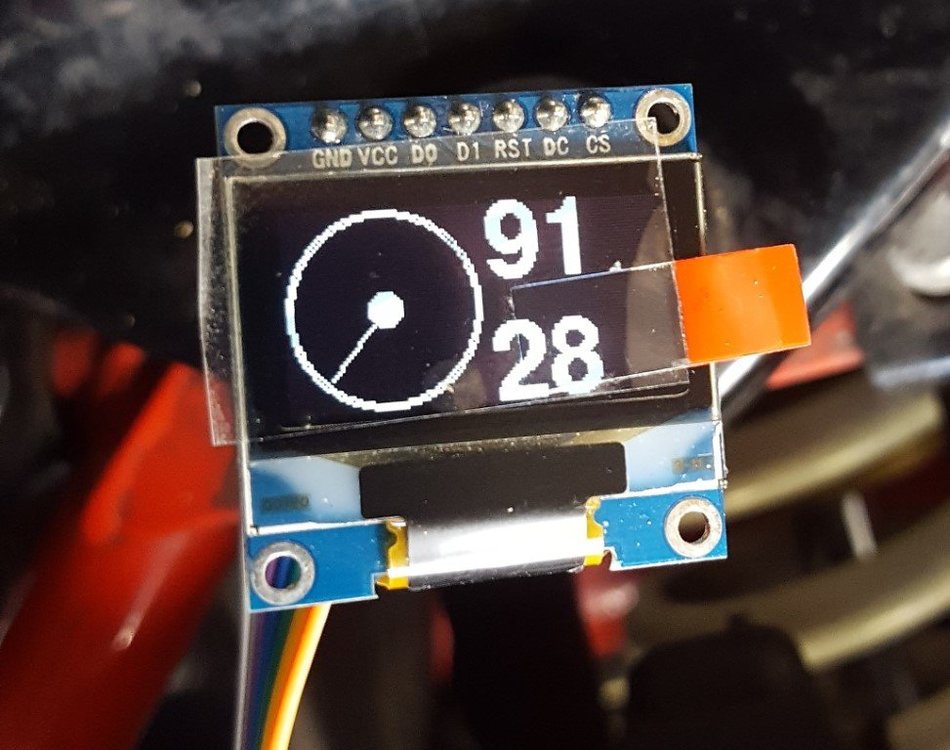

  10. Got the GPS module today. Just amazing that these things are so small and cheap... Imagine showing one to John Harrison... Anyway, thanks to Beard over on Guzzi-Forum.De of GuzziDiag fame, for helping with a few pointers regarding the ECU and the interface. The trick will be packaging it so that it's descrete and readable.
  11. I am using a very small OLED display which is big enough for 2 digital readouts and 1 bar graph or dial. These can be any of the data items available from the ECU. These screens are very cheap and very clear even though they are less than an inch across. Could have 2 or 3 of these mounted together... I will also test a small colour TFT LCD screen which is 2.4" and has a touch screen. It should allow maybe 6 things to be displayed. Just need to see which works best in sunlight. Also have a tiny GPS to add, in order to get MPH and then work out current gear position.

  16. Had a play at this today: This is obviously a birds nest prototype but it works fine!
