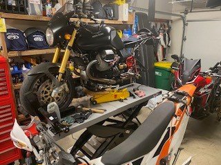

  14. Removed plate and mechanism and got gears to neutral. Got the rear wheel off the lift and was able to move the shift forks to neutral and then align/reinstall the gearshift selector. Ran through all the gears properly while on the stand. Pulled it off and disassembled completely. Understand how the detents on the top gear function. Will post a couple picture with questions tomorrow.

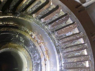

  23. These are all the many tasks I aspire to tackle and complete on my Scura, but admittedly get "scurred" away because I'm not licensed in any state to practice internal medicine. Installed Pressure Angle's Roper Plate with the gasket assist from SwooshDave after meticulously cleaning everything out and replacing the filter. Now have the rear wheel off under the impression that I'm actually going to go tackle the clutch plate inspection, but balked at it once I realized that a couple of MG specific tools will need to be purchased in order to do so AND that the manual says to remove the engine. Heck, it's only nuts and bolts, right? Then I see this post and figure that if we're going to 3rd base on the first date we might as well steal home. One area of initial concern is the gearing on the rear wheel. First time I've ever pulled one off and can see metal shavings in the grease along the gear splines. I'll get a picture tonight and try to add it here.
