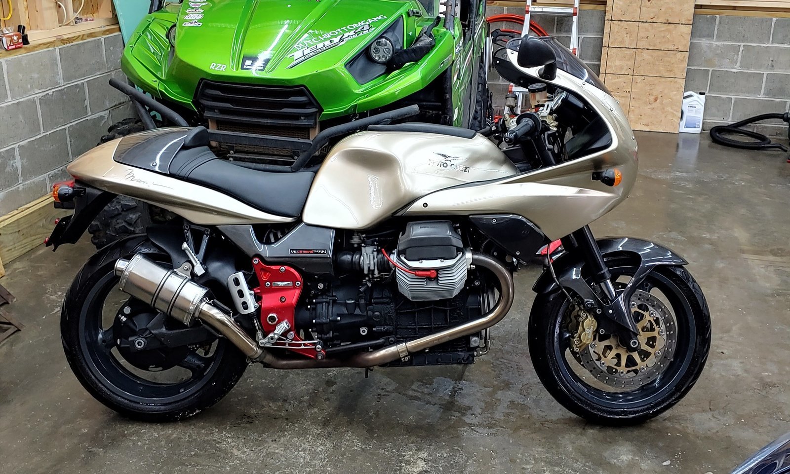

Is anybody on this forum also on the Facebook v11lemanz? I posted videos on there of the startup.... You can tell by my face that I was worried a little when she didn't start on the second try.... Although I know not everyone is a fan of Facebook.....

Just ordered all the gaskets and other goodies needed to put this jigsaw puzzle back together. I really can't wait to hear and feel the rumble of the big v twin again.... Been way to long
