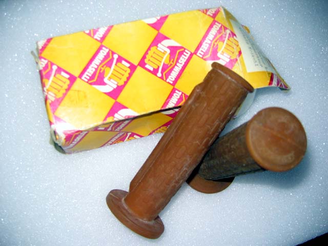

  9. I'm taking a guess here but it sounds like the grips are Tommaselli. I have a pair on my Ducati 250 single and I bought this pair to replace the old ones, which are still in good condition maybe 10 years ago. I dug these out of my parts stash...which is pretty sick, considering. These still have the packing dust on them and are the Daytona special model 1101 ones, The ones on my Duc are a alittle different, but all the gum rubber Tommaselli's feature the throttle ridge, at least as far as I know. I don't know if these are made any more...maybe an Ebay item. BTW if you find them anywhere, buy them...they are worth $ to collector types. They are too retro for my Corsa Rosa.... but are great for the little Ducati, which is like a bicycle with about 25 horsepower. I'll have to shoot a picture of it next to my Corsa...they really are a great pair: both RED I agree with the comments on Pro-Grips. I have these on a lot of my other bikes and like the grip and feel a lot. My Guzzi has been rock solid, only thing weird has been the "Tank Suck" condition, I 'll deal with that when I pull the carbon cannister though
