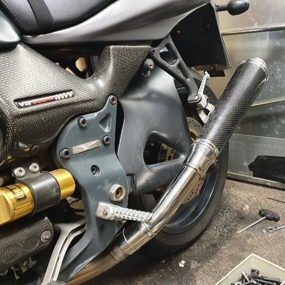

No such thing as "to much carbon" Was lucky enough to find a used pair as Mistral doesn't make this version anymore.
