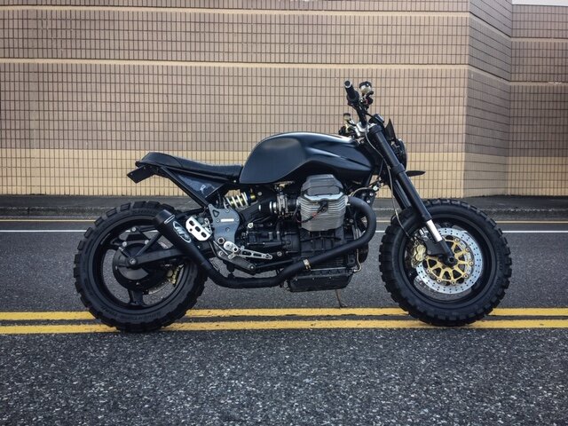

    Well everyone, glad to report the V11 is back on the road and kicking ass! I got the new motor put in yesterday and wrapped up all the small things today. I installed a new Roper Plate (very sweet by the way @Pressureangle) highly recommended and a very easy install when the motor is out of the frame and flipped upside down I put roughly 30 miles on it today and nothing but smiles, had to stop and get some beauty shots. A short backstory, this bike was wrecked and was pretty gnarly. I refinished the gas tank, made a new subframe, new headlight and control area. New bars, grips, bar end signals, new digital speedo among other things. Then the motor went, so bought a new/used one on eBay with 3000 miles, went through it and tossed it into the beast and here we are! Now, my V11 may not be everyones taste which I totally get but wanted to turn it into a sweet rugged machine, something to match with the grunt of the motor. It is by no means a Scrambler but has a vibe as such, it's a pavement only bike but the knobby tires really handle well on the street. I can still carve the curves and hit the highway with no issues. I don't ever ride in the rain so went with POD filters and no rear fender so no one complains about that... Anyways, got the bike back together and want to thank you all for the help with my questions and the wealth of info this forum contributes! Pics posted below

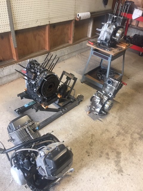

  11. Good idea, I actually do plan on doing this as well. I have leak down and compression testing instruments. It's great having the motor out already. Makes most of this much less painful haha. Thanks!

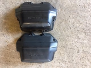

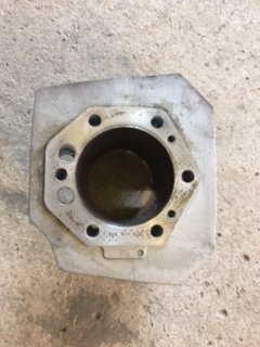

  20. Hey there! So I am replacing my V11 motor with a replacement soon and will be parting out the stock motor. It had roughly 16k on it when the right connecting rod bearing went out. The motor itself is in fantastic condition still. I could have had this fixed but would rather replace and part out the old one to re-coup some funds...Anyways Below are a few pics. Pretty much the entire motor will be taken apart in the next day and parts sold off individually. I'll get an updated section of pics here soon too but for now what you see is just the right cylinder side. Shoot me an offer on what you're after, I have no use for the old stuff and would rather it not collect too much dust My contact number is available too. I am happy to ship items as well! It's easier for me to email or text pics so just keep me posted. Cheers, Max List: x2 valve covers-$100 Pushrods, hardware, rockers, rocker holders-$100 Right side cylinder: $150 Bad connecting rod and good piston: $60 Right cylinder head assembly in good shape: $150 Oil pan: $100
