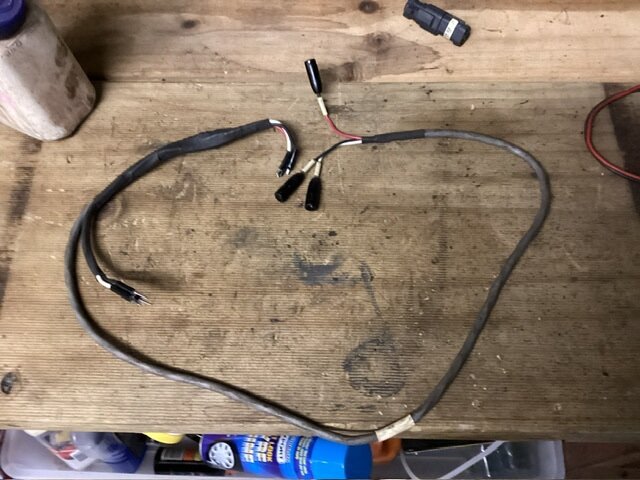

    Yes @gstallons , this is an old cat diagnostic lead not ideal but serviceable. With the tps in my hand but connected the minimum reading is 204 mv . With very slight pressure using a screwdriver in the slot it will get down to around 150 mv.
  11. TJH
    Help
    Hi , Thanks for all of the responses and information provided. I’m using a modified caterpillar test lead (pictured )which is not ideal and may have contributed to my confusion. After testing the old TPS using the info above it is definitely faulty and doesn’t have the range as described. The new TPS has the full range to 5v but the lowest reading is around 200 mv whilst mounted. ( ie the slotted holes run out of adjustment. I can get 157 mv with very slight pressure once the screws are removed. ) I might try to elongate the screw holes slightly to achieve 157 mv. I will have more time over the weekend to work on the bike
