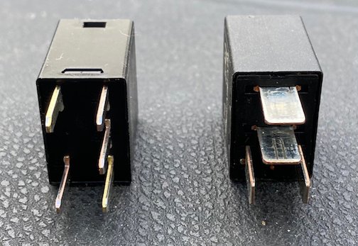

  3. YOU GUYS ARE GENIUSES! Everything on my Lemans works! 🙏🏽 Had my doubts about the relays. Now I have a working clutch, high beam, horn, and tachometer. Yes!
  4. I had ordered these — looks like the numbers differ — Amazon threw them up as an option and I didn’t double- check. OMRON ELECTRONIC COMPONENTS - G8V-1C7T-R-DC12 (2 Pieces)- MICRO AUTOMOTIVE RELAY, SPDT, 12VDC, 20A https://www.amazon.com/dp/B071J39P7V/ref=cm_sw_r_cp_api_glt_fabc_P99Z6TAWGP6EACWJZ3Z1?_encoding=UTF8&psc=1
  5. Thanks. I just ordered the Panasonic replacements, which looked correct on the Digi-Key website. Hope this solves all my problems!
  6. The OMRON replacement relay on the left; original on the right.
  7. I bought five OMRON G8HE-1C7T-R-DC12 but they don’t fit. What is the generic relay for the V11 Lemans?
  8. That worked. Thank you Tinknocker. Thank you all for your excellent advice. Now, my high beam, horn, and tachometer don’t work. The fuses are all OK. It’s a mechanical tach, correct? Where should I start to troubleshoot the high beam and horn?

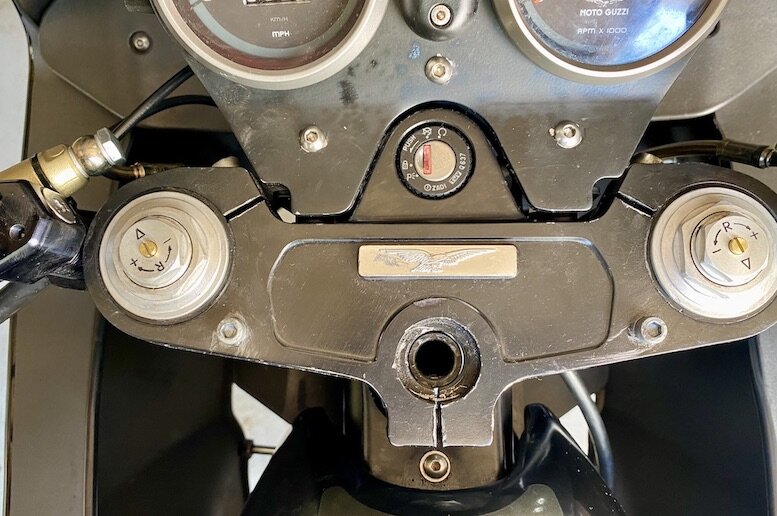

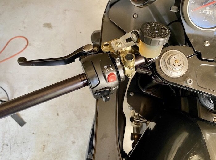

  14. Excellent -- thank you. I put it back to rights after dinner, and by keeping the clip-on clamps below the triple clamp and extending the bar post all the way up (4"), was able to get the rise I wanted, keep the stock hoses and cables, and not worry about disturbing the front end. Will post photos tomorrow.
  15. Yes, good thought, but I couldn't get that to work with the right bar, and don't want to switch out cables and hoses. Maybe I'll have to...

  18. At 61 I can endure my Lemans riding position for one hour but not three. I checked out all the bar riser options and chose the Apex 4" Riser Clip-On Set @ $269 delivered. They seemed to offer adjustments in every dimension, with the possibility that I would not have to change any hoses, cables, or lines. I first tried the Apex clamps on top of the triple clamp plate without changing the position of the clamp on the forks. The left side went perfectly, but the right side throttle cable wouldn't reach that far. I then pulled the triple clamp and placed the Apex riser clamps beneath the plate, reinstalling the plate to be even with the top of the fork caps. After trying every possible position (and after discovering the starter button housing has a pin and that I needed to drill the bar), I got it all to work and to feel right from the rider position. I will include more pictures in separate posts (the size of attachments is very limited). Three questions -- (and please let me know if I did anything really wrong) (1) The threaded cap at the center of the triple clamp plate no longer reaches the threads, as the clamp has been raised. What replacement fastener I should look for? I imagine not replacing it would be a very bad idea. (2) Will there be noticeable changes to the front end handling since I raised the clamp about an inch? (3) The PO kindly left a Throttlemeister on the bars. I pulled off the weighted bar ends with no trouble, but I can't figure out how to removed the inserts in the stock bars in order to install the Throttlemeister in the new bars. Anyone know how to do this?
