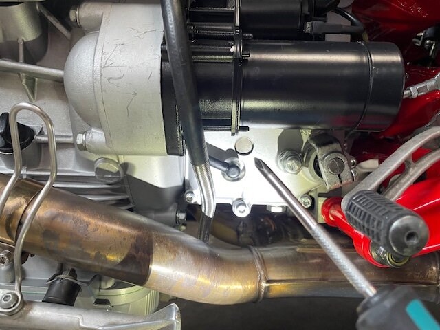

Minor update. Before disassembly, I wanted to be 110% sure the oil is coming from the spot, so I cleaned it again. As I was messing about in that are with paper towels and mini screwdrivers to get the last of the oil out of the crevices, I noticed...that post is absolutely loose. I can spin it quite easily with the tip of a screwdriver pushed just off center of the post from the outside. Round and round and round, no problem. So, my intention is to remove, degrease, and glue/epoxy the post in place. At the risk of instigating a "which oil is best" conversation , is the consensus on best adhesive for this steel post to aluminum case application - JB Weld? My default is probably that, but I'm a little concerned, while the post currently spins, it's actually quite a tight tolerance fit. Obviously not (successfully) press fit, but maybe...only a couple thousandths (imperial) undersize. So probably need a relatively thin adhesive to achieve the bond the full 360 and still allow a fully seated post to maintain parts alignment. Thoughts about: a. JB Weld b. Cyanoacrylate based adhesive, gel or thin c. Red Loctite d. Other
This is such great feedback and gives me good direction. Many, many thanks. Photos and diagrams thumbs up. Not sure if it's a "this weekend" project or a "next weekend" project. But @swooshdave won't let it drift much beyond that :). Appreciated! Chris
Hi friends: I have a 2001 Greenie I've been working to bring back to life (thanks for all the forum assistance and info). I've ridden it a bit around town, and have one current oil leak that I'm hoping for advice on. It's on the left side of the transmission case, visible just under the starter, adjacent to and slightly above the neutral warning light. It's a circular piece of steel that pokes through the case and is a little recessed (see photo - I'm pointing at it with a screwdriver). I have a manual, but can't see where that piece is named anything in the Section N Gearbox chapter. It does show up in one VERY small diagram there (see photo - I'm pointing at it with an Xacto) on p. 26 section N, but I can't work it out. And because it has no slot or fastener head on it, I'm struggling to imagine how to get it out (to put on a new o-ring or whatever) other than take that side cover off. Before such bold exploratory surgery, I thought it's best to ask :). Attached are a couple photos. The leak is just a small drip, but it does run down the side of the case and onto the pipe. I haven't ridden the bike extended miles yet, but am concerned I'd end up on the side of the road out of town with abundant hot oil on the outside, not the inside of the tranny. It does form a drip VERY slowly, maybe once a week, while cold in my garage. All advice appreciated!
It's a spherical bearing. Yes, factory mount points.

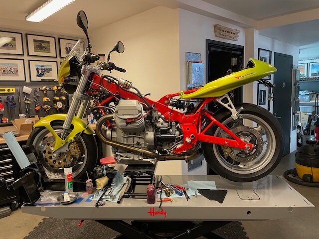

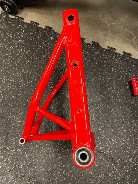

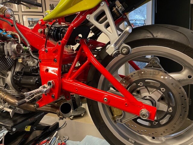

Hi folks: I recently refurbished a 2001 Greenie and went through the swingarm color and rust repair process. Thought I'd share my results. Version 1.0, I had the wheel off, and planned to re-grease the swingarm pivots. In doing so, I discovered a bit of rust and a notchy bearing, and...so it began. At first I went cheap, with just a wire brush to the rust, and rattle can black to match the stock color. And that looked...well...better than rust. So commence V2.0 - and only after giving myself a stern talking to about...finish what you start, young man. I took the swingarm, pork chops, rear subframe and battery basket off and powdercoated all. I figured they really should be done at the same time due to color matching issues, and if not perfect, at least they would match each other. Plus, I had chips/scratches on all, and once I saw those, I couldn't un-see. Last, it was a chance to sand off any original welding splatter, the helmet lock spot, and so on, cleaning things up visually. After consideration, I went with red, red, red, and am SO happy I did. The color isn't an absolute 100% match to the original, but that's OK (to me) because the spine frame at the front of the tank is separated from the rest of the red bits. The new paint is just a bit more orangey-red, but not that far off. And let's agree, what I painted is the EASY part to get to :), which I considered enough. I've permanently removed the rear tire hugger and plastic swingarm end covers because I really think the braced swingarm looks great, and the hugger is of questionable function/appearance. More in another post about the simple replacement fender system I made, inspired by others on this forum, that works well and was super cheap. Attached are photos of the powdercoat result. I really do like how the bold red now runs the full length of the bike. But that's a matter of opinion, of course. In any case, you now have these photos to refer to when considering your own situation.

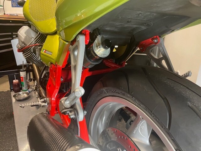

Hi Friends: I thought I'd share a bit about my experience on this topic. I purchased and revived a 2001 "Greenie" which had the original Sachs unit. After looking around, reading here, and reflecting on past experiences I purchased and installed a Penske on my bike. It's their 8983 style with remote reservoir part number PS-8983-MOTOGUZZI-V11. For my 170LBs they recommended a 500LB spring. Please see attached photos of how I mounted it, which came out nice and clean. The unit bolted in easily, and the bike stance remains same as previous (I dropped the front end so 10mm fork shows above triple clamp to put a bit more weight on the front end). I'd describe the ride as plush-but-controlled, very much in line with my previous Penske experience on a VFR. It's almost a little (intentionally) soft right at the beginning of the stroke - which feels comfortable on uneven urban streets and secondary back roads. There's absolutely no harshness, but is supportive. Penske delivered the shock in about 2 weeks. I just called them directly, explained make-model, and it couldn't have been easier. I paid full price. For what it's worth, past experience with Penske on race and street bikes indicates they also have the benefit of being easily and endlessly rebuildable. Nothing complicated, just good quality, Made in USA, easy parts availability, and any shop that rebuilds shocks can handle fresh oil/seals on a Penske. Not cheap, of course, but a buy-it-once buy-it-right sort of solution. Also, looks quite proper on the bike IMO, with relatively subtle color shock/spring details that do not try and compete/clash with the rest of the bike. I hope this helps someone who's considering improving their suspension, and maybe shortens your path regarding mounting etc.
