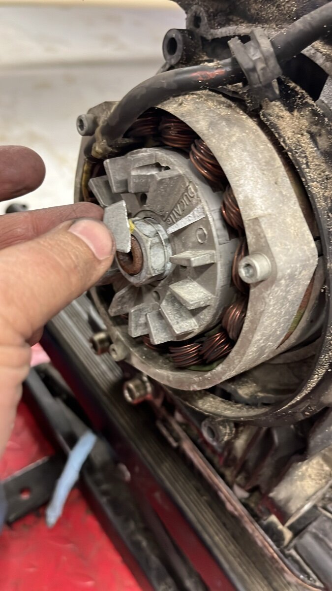

  5. So obviously holding the rotor with a screwdriver against the rotor fin and adjacent stator housing bolt head didn't work... what's the trick to keeping the engine from turning while you remove the nut off the rotor? I need to pull the alternator to replace my leaking timing cover gasket... hopefully I haven't just cost myself $400 worth or alternator by breaking off this cooling fin? I also tried having my wife hold the rear brake with the transmission in gear but that didn't work either (too much leverage at the crankshaft I guess?) I quit for the night before I broke anything else out of frustration. And I did check the service manual but step #1 of alternator removal is to remove the engine from the bike (!!!). Surely there's a way to avoid that, isn't there?!

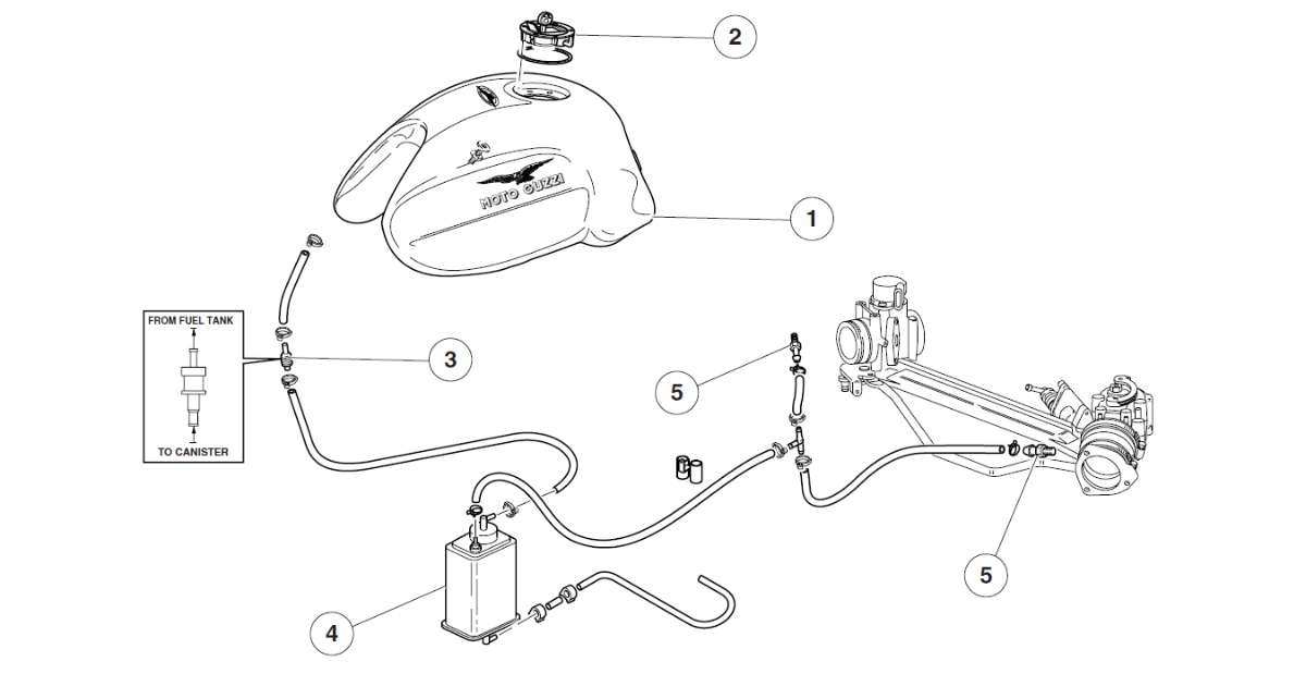

  6. Thank you @docc! It looks like that’s exactly what I have going on. Odd that they left the rest of the hardware though. They just yanked out the two pieces of hose at the T-fitting.
  7. I'm trying to locate the actual fittings on my '03 that correspond to item #5 on the attached diagram of the EVAP system. The "T" fitting on mine is broken off and as dumb as it sounds I haven't had any success in tracing the hose path to find the connection spot(s) at the throttle body. Can someone please post an actual photograph of where those fittings are and what they look like? Are they upstream of the throttle plate or downstream? I would think they'd need to be downstream to operate in a state of vacuum but I'm just not seeing anything there on my bike.
