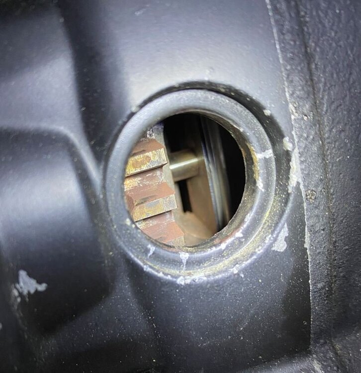

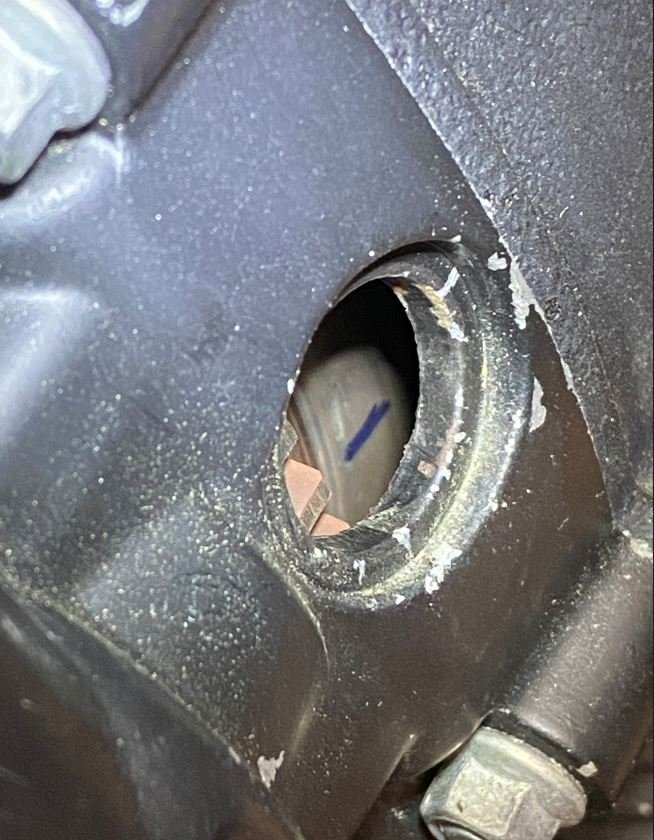

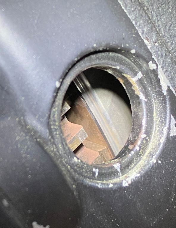

  3. Hi everyone, Thanks for the further replies. @Lucky Phil, I just took the inspection cover off and took a couple of photos which should be attached. There is a pen mark visible. It it possible to tell much from the photos? I have messaged cash1000. Cheers Jody
