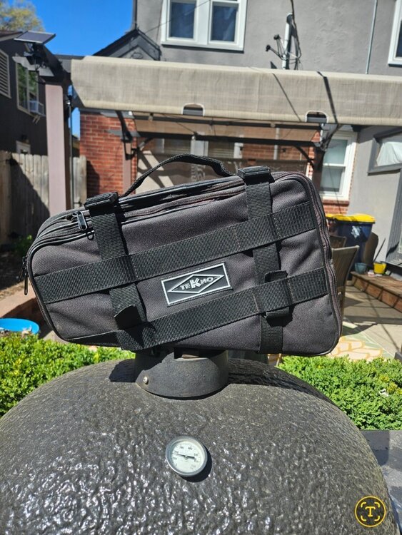

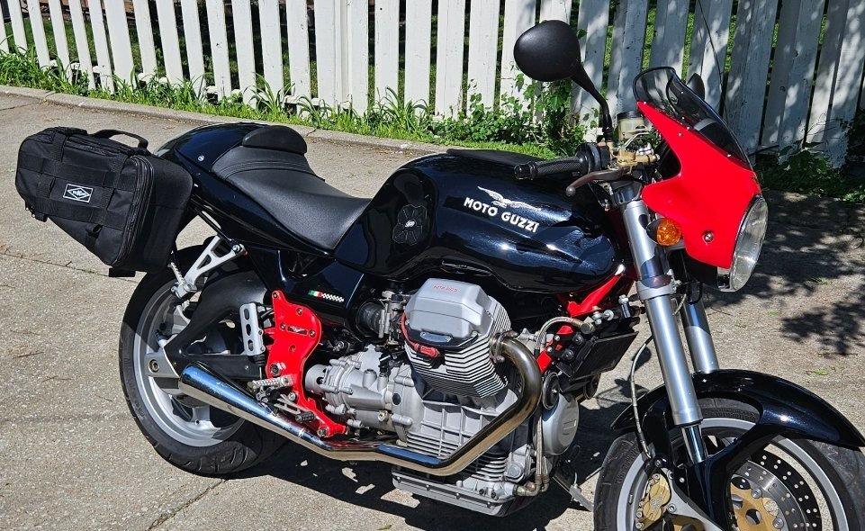

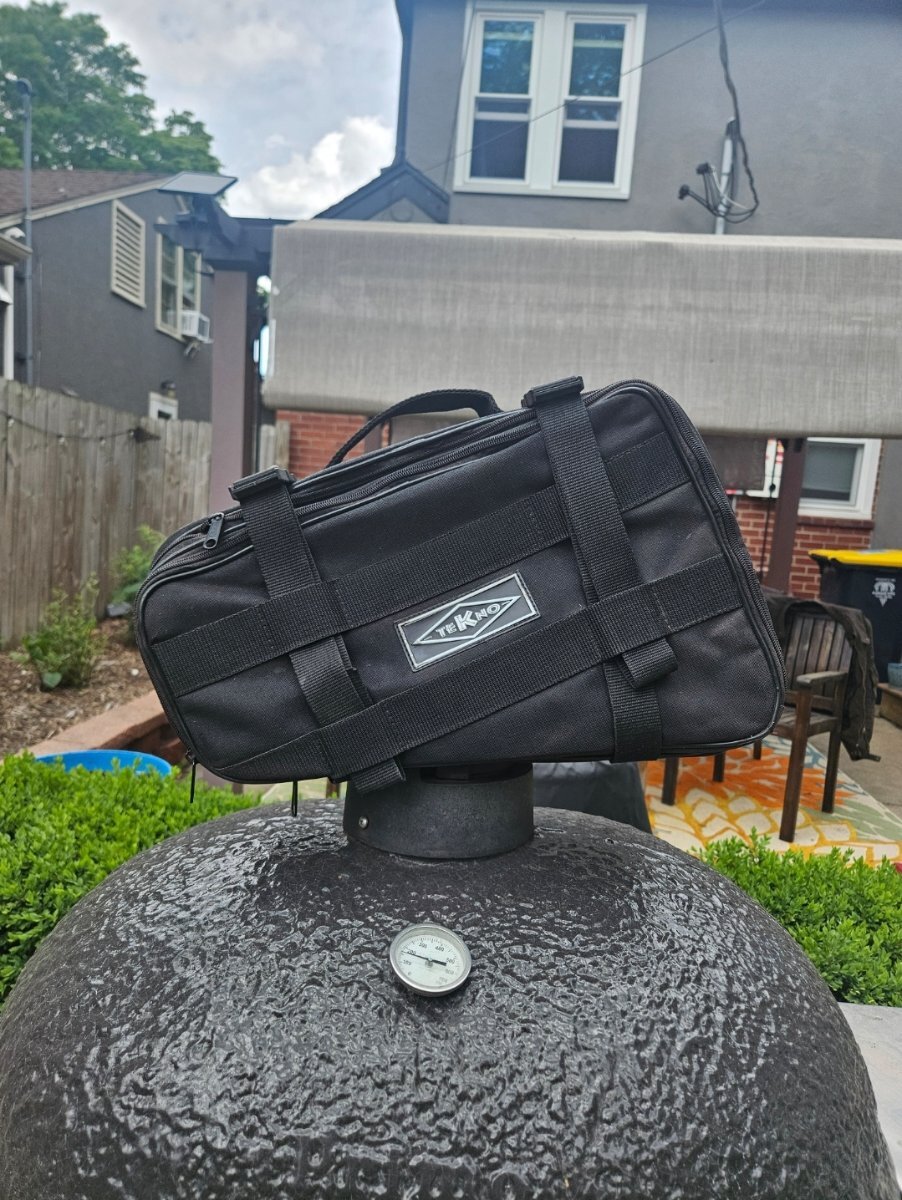

When I inherited my dad's V11 last year I always planned on getting rid of these old , purple faded Tekno bags. With them being all worn out I thought it made the bike look bad. Then I realized that these things are rarer than hens teeth! I looked at a few older posts on here but didn't see anything that wowed me. After searching around I found a post on a Harley forum recommending Kiwiw Scuff Cover for black leather shoes to use on faded synthetic bags. At $5 a bottle I figured it was worth a try. What a HUGR difference using this as well as some zipper lube has made on these bags. They don't look brand new, but they look like the rest of the bike - pretty good for it's age! Pics from what they looked like when faded, one coat of the scuff remover on the bags, and then finally 3 coats with the bags on the bike
