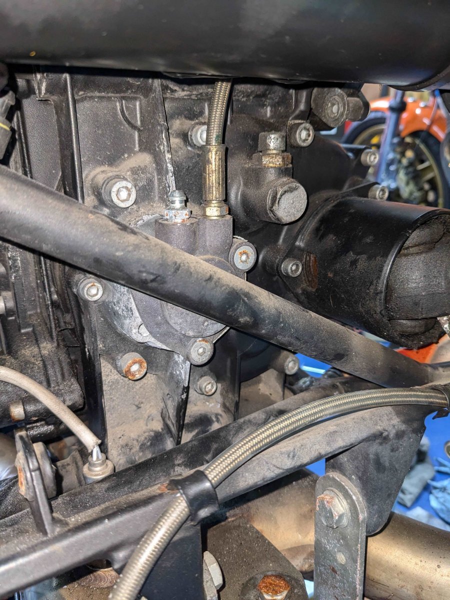

Here's a pic of the remote bleeder I made up with some stainless hose and fittings. The actual bleeder is from these guys, they do a zinc plated version and stainless so I treated myself! https://www.competitionsupplies.com/remote-bleed-fitting/remote-bleed-fitting-stainless-steel However, although the clutch had been working fine before I touched it (going purely by lever feel), it proved impossible to bleed up with the remote setup, air getting in somewhere? I ended up fitting a banjo with a bleed nipple at the master cylinder end (I had one spare from when I rebuilt my Guzzi T3 linked brakes which were a nightmare to bleed afterwards!) and reterminating the hose fittings on the bleeder, in case I'd trapped some stainless wire from the hose cladding inside an olive or something? In the end I was able to bleed it up ok with my vacuum bleeder and all the nipples ptfe taped to prevent air coming in. I am waiting to see if the clutch lever remains firm despite lack of any obvious leaks, before I refit the swing arm etc. Possibly in bleeding (and obviously pumping the clutch lever repeatedly) I've exposed an issue with the master cylinder which has presumably sat for years unused, but everything looks nice and dry? This has proved to be the most frustrating aspect of the recommissioning so far!

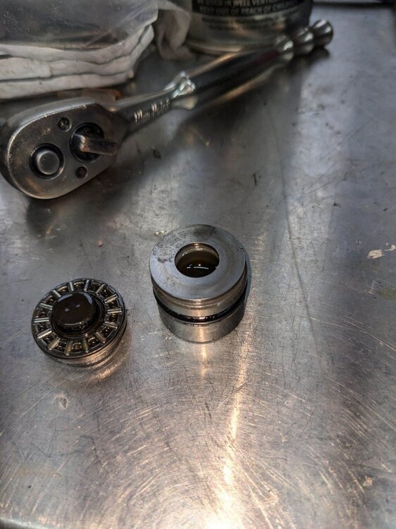

You might be right Docc about the bleed nipple on the clutch slave. I removed the rear subframe, which is a swing arm out job and checked over the slave cylinder. No leakage apparent and piston in immaculate condition. The thrust washer on the end of the clutch pushrod had tiny (and I mean tiny, no surface corrosion evident with a fingernail test) witness marks from the radial bearing it sits against - see pic. Presumably because it's been sat in that position for over a decade and the oil film broke down on the top half? Anyway, nothing to worry about. I flipped the hardened washer around so the clean side is against the bearing, changed the o ring that seals in the gearbox oil and replaced everything with A4 stainless fasteners (copper greased) after respraying the corroded paint with etch primer and the VHT case paint. Looks a lot better and a good match for the rest of the cases. THEN I decided to fit a remote bleeder setup (as Guzzi did with the Griso), what a pain that turned out to be! More later...

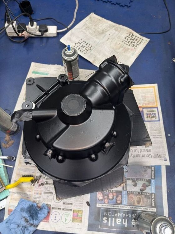

OK, apologies for lack of updates as life took over, but have made a fair bit of progress. First off I dropped the sump and changed the filter and checked the screen, totally clean, and no signs of anything untoward (corrosion, emulsified oil). So decided NOT to wait for the Roper plate from Gutsibits and button it all back up with new stainless fasteners. Of course the roper plate arrived a few days after this decision . The rear bevel box was a right mess with flaking paint, so I took out the rear wheel and then the bevel, all pretty straightforward. Removed all the flaking paint and a couple of coats of etch primer followed by the VHT case paint (already established as a good match for the rest of the satin black on the bike) and looking a lot better (see pic before final sanding and top coat). With the wheel out I could take a better look around swing arm and gearbox area. Looking around the clutch slave cylinder there was some localised paint flaking underneath it (2nd pic). I reckoned this MIGHT be leaking seals and decided to take a closer look at the slave, given how difficult it is to get at (Caution: understatement alert!!) With the later frame with additional lower bracing there is NO WAY to get that cylinder out without removing aforementioned subframe. At the same time as all this I attempted two different methods of greasing the front UJ. Yes, the bit I'd been dreading. There's a joke in Norton Commando circles that the bike was built around the horn (behind gearbox, in front of rear mudguard). Well I have concluded the V11 assembly line in Mandello started with that front grease nipple! 1st attempt :- heat grease delivery tube on one of my 3!) grease guns and bend it. Result - one broken tube 2nd attempt :- try from underneath with a flexible hose. This required taking a small notch out of the grease gun head to latch onto the zerk. Result - grease all coming out of the notch, none in the zerk Anyhoo, given the rear subframe has to come out for the clutch slave cylinder access, and that means the swing arm too, I could do the UJ (etc) greasing with all that out of the way... More instalments later!

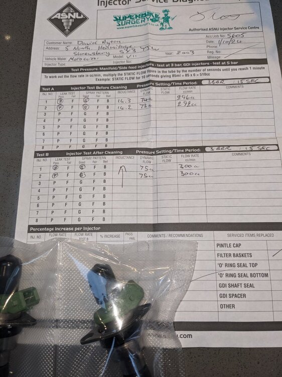

The freshly serviced injectors were waiting for me when I got home today. The ASNU report showed they were in pretty good condition before the service with "good" spray patterns and flow rates of 296 & 292 cc/min Vs 300cc/min for both after the service. This is good news as either someone has already cleaned or serviced them or I suspect they've been stored dry (?) which should mean the pump will be ok too. This is guesswork on my part and I know injectors suffer less from ethanol than carbs but good news anyway?
