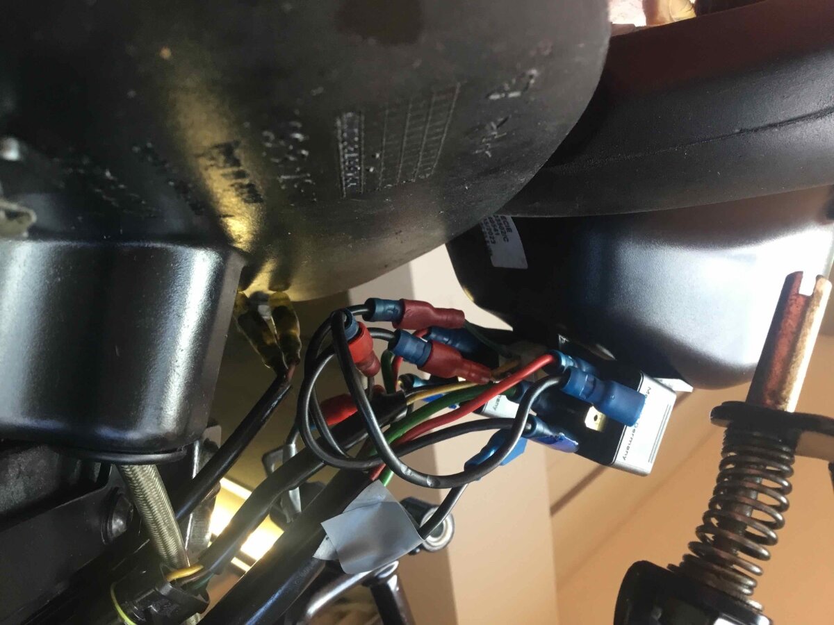

  10. Reporting back….both green wires disconnected from the battery, ignition off, no high-beam! Image 1 This was a good start….! Then, both green wires were connected to battery negative as many have suggested, ignition on……success!! Image 2 All lights worked as they should do! And to check I didn’t stuff up anything else… she fired up as before! Big thank you fellows….! If any of you fine helpers are in Sydney anytime soon? …..dinner is on me! Regards, tennitragic

  20. A new day and down to the garage I went….! Firstly, wiring is how the bike came to me. Too timid to do any wiring upgrades….! Learning on the job…..the old adage of “a little knowledge is dangerous” still applies to me electrically! Only got so far today as had to put the Battery back on charge. Showing <10 volts. Battery was showing 13 volts when I stated this task. However, did manage one task, begin to swap the relay wires to see if one of these added relays is the culprit. As shown in the photo, noticed if I swapped pin 86 wires on each relay, low beam began working correctly with ignition on and switches in correct positions! But…. high beam was then permanently on with ignition off! And handlebar switches had no impact - still on. Turn ignition on and high beam could not be activated. Dash high beam light worked though…. Does any of this added information shed any more light? Pun intended….! Overnight I did look up ‘relays’ on the forum and found a 2011 post from kiwiRoy about adding a headlight relay with diagram included….perhaps this post was the instigation for a previous owner of my Tenni? Regards, tennitragic.
