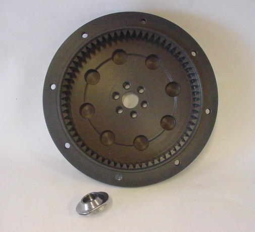

  20. I'm doing my best to attempt to clarify. I'm sorry, I didn't intend to muddy the waters further... So that first picture I picked up on from the link John posted is not from a RAM single plate? I take it, it is the one on the top left of the most recent pic John posted? Well, that still is substantially different to the stress failed pic. Nige.

  22. ...and the very dubious 'improved' guzzi copy. This is a failed one I picked up from a linked thread.
  23. OK then, John... So we have two different designs here......The substantial and hopefully sound genuine RAM offering:
  24. Would incorrect torque on the bolts cause the fracturing of the aluminium flywheel? Does the genuine RAM clutch use an aluminium flywheel? Nige.
