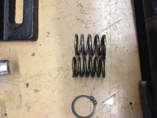

OK New clutch plates and springs arrived. Old clutch plates measured 7.45mm and 7.43mm old springs ....28 mm free length New clutch plates measure 8.13mm and 8.14mm new springs ...29 mm free length appears to be two different styles of springs new spring on the left in picture anyway on to the clutch slave.Brand new from Moto Guzzi. It Leaks Somehow it is machined different where the hydraulic hose screws in. Its like I can't get it tight enough....anyway ....Scud sent an extra he had and it works fine.(Thanks) Tranny is in...just need to fettle with some stuff tomorrow as I reassemble. andy

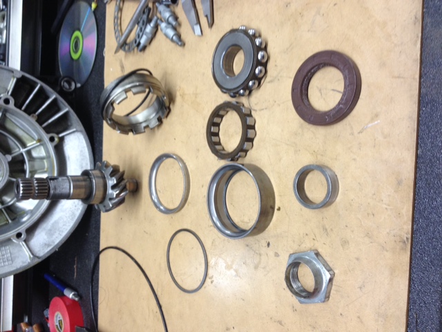

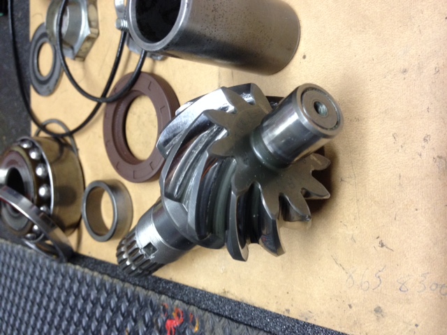

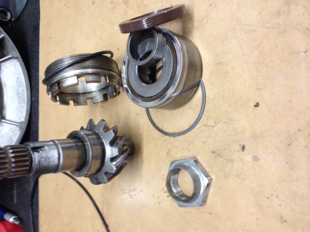

and #2 and i also don't know why the site turns everything 90* anyway there is a shim first (on reassembly) then the bearing assembly then the castled nut ...of which the seal goes inside and the 0-ring goes in the groove on the OD of the castle nut then the spacer and finally the 36 mm nut I fit the seal to the inside of the castle nut and the o-ring into the groove. generously coating each with a film of grease. then install the castle nut. then lube the spacer up and gently push it home.... it has to go through the seal....so be careful. then install the 36 mm nut and torque to 180 -200 Nm

Sorry I just read your post again. clean the inside threads where the ring nut is. clean real good. possibly also blow out with air. You should be able to take a pin punch and tap the ring nut loose. might take a few hard hits to get it moving then it should come off with your fingers. Then the big nut comes off with the above procedure. andy
Hi Roberto, No special tools required. Just a socket to fit the nut and a long cheater bar. If yours is anything like mine, I have to loosen the nut while the diff is still mounted on the bike. I have never gotten mine loose with air gun. It just batters the gears against each other. I will have to look up the torque spec,but as I recall it is very high when compared to most things on the bike........this is my unfortunate disassembly process... 1 - remove rear wheel 2 - remove rear diff and disassemble rear portion of driveshaft and remove completely 3 - reinstall rear diff and rear wheel 4 - socket on nut w/long persuader bar ratchet handle( i use an old fork tube) bike needs to be on ground and maybe a 2nd person to apply rear brake while you try and loosen nut. 5 - disassemble again-fix leak-reassemble in reverse order best of luck. It really is not hard to do but sometimes you think you need godzilla to that nut loose andy

I honestly think it left the factory that way.I may have been a little vague. I first noticed this,oh ,say, 2003... when I had my first weeping of the rear drive. Upon disassembly,that is what I discovered. And that was probably 80 to 90 k ago. no metal or swarf in lube....ever. I did reset the gear depth a bit back then. Not trying to push my luck, I just always find it amazing how "bad" something can be mechanically and still function andy
have to look close to see it. been that way for about 90k. never find any material in the oil when I change it. I'll keep on riding . andy
