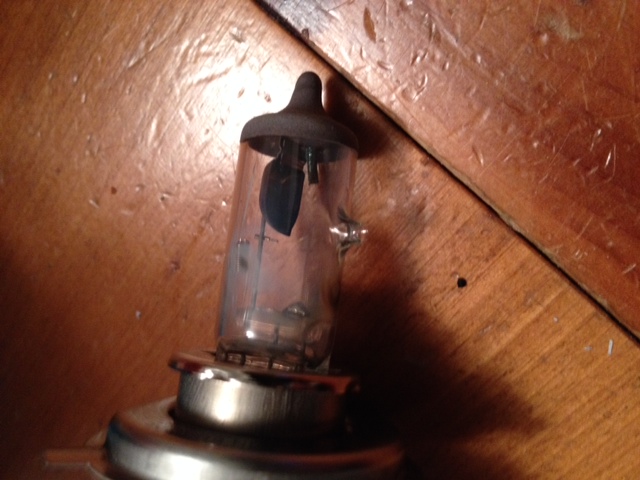

I went for a little ride the other day. Hit the freeway to get out quick. Looked at the Tach....no worky...went another mile and thought "this is not right". Pull over, bike idling, hummmm No headlight either.check taillight ....hummmmm no taillight either. Pop the seat ...15 amp light fuse is blown. No biggy ..put another fuse in ...no tach, headlight, or taillight. I go home. Today I pop the headlight out ...bad lamp...Pop the taillight out...bad lamp...don't have another tach (really ! maybe). Swap lamps out and try to start. battery dead. Charge battery. Start bike ...headlight works...cool.....taillight still no worky....tach no worky...fuse cover is off and I see the 15amp fuse blow again. Have I mentioned before that I hate electrical... I think I have another voltage regulator but I have to go look. I have seen a lot of lamps fail for whatever reason, from 55w headlights to 10000w TV lamps. This one tried do do its impression of a solar flare. Help

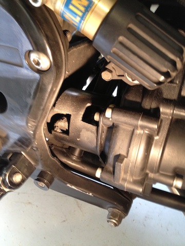

I had the swingarm off for whatever reason ..at that point you just take the 3 bolts off and remove it, make the modification and reinstall. you would have to get creative to modify while still mounted on the bike. I used a dremel cut off wheel. -

You are correct Sir....thats what happens when I speak before looking at what I had done. The access hole that I made might be a little larger than need be...( in a hurry). Docc is right ...the forward "windows " are for the u-joint bolt access. I don't work in the steel industry but that particular piece is "hefty" and in my case I think still more than enough to contain the driveshaft should the joint fail. happy trails -
