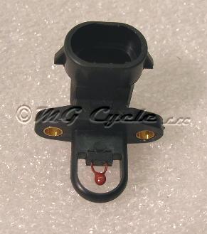

  8. Wow, I've never seen that type of sensor in anything but an air box. Where do they mount it? Here's a 30729331

  10. Now you are losing me G2G. The oil temp sensor as guzzi calls it is a coolant temp sensor in any other application - brass sensor probe designed to be submerged in coolant. Part #29729461 The air temp sensor is exactly that. A plastic sensor body with an exposed thermistor probe designed to sense air temp. Part # 30729331 Two completely different sensors for two different purposes. I'm quite sure they are spec'd to be accurate in the ranges needed.
